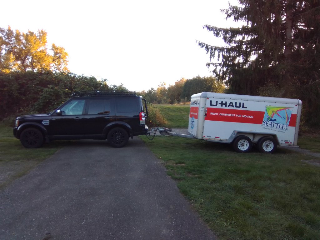

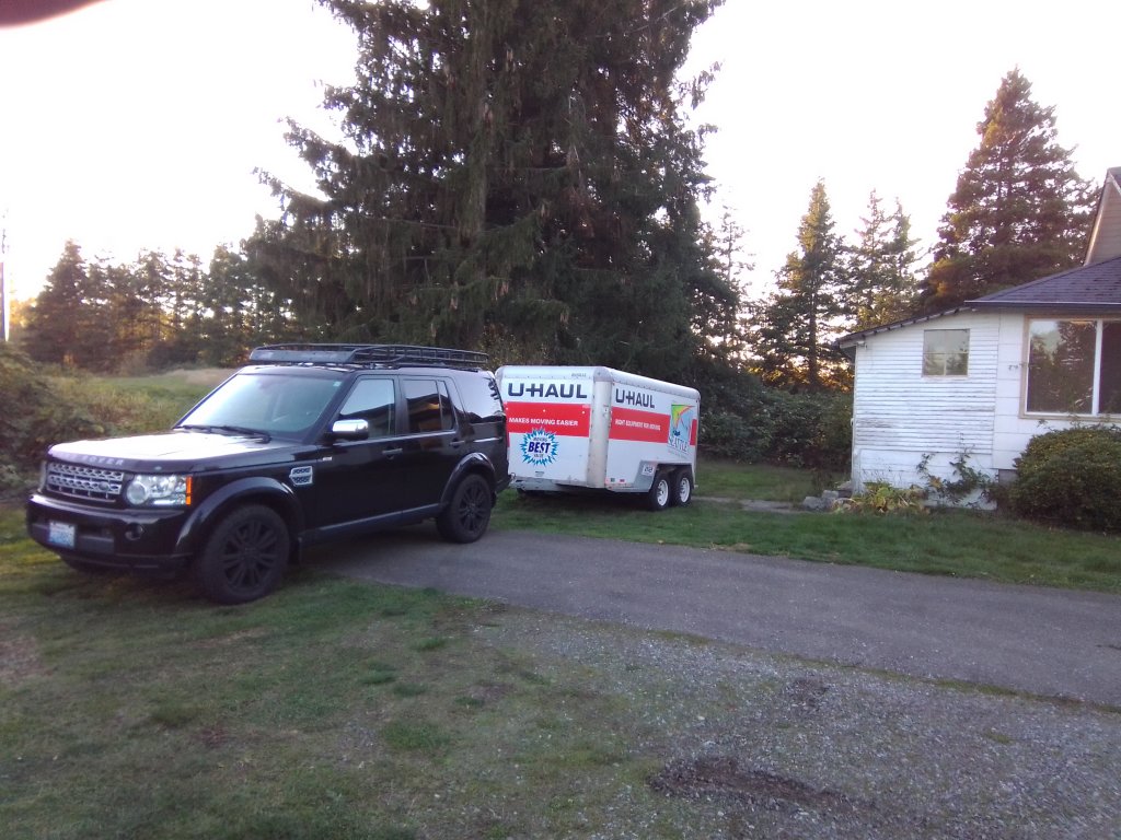

Towed with mine for the first time. No problem. All the towing equipment was DIY. Happy it worked out.

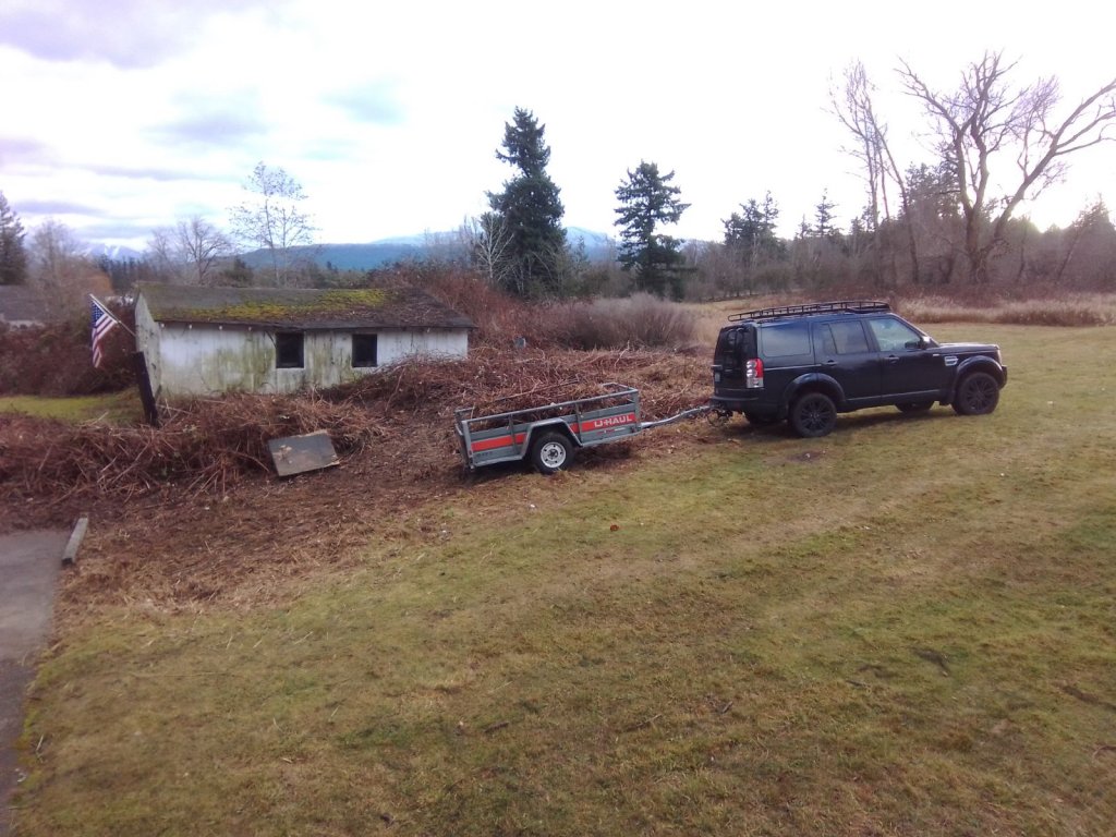

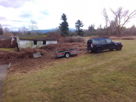

Used the LR4 to pull a utility trailer around the property. I recently hand cleared a huge blackberry mound that had grown onto the roof and into the side of a 100 plus year old outbuilding. I decided to put the LR4 to work as a farm vehicle. It did great. I kept it in elevated off-road height the entire time to help navigate the fields I was crossing with the utility trailer loaded with blackberry vines. Felt good to put the LR4 to real work, utilizing its off-road and towing capabilities. The trailer is 5' x 9' and weighs around 1,000 lbs. They offered me the larger 12' x 6', twin-axle, model that weighed over 2,000 lbs. but I told them that I wanted to keep it light since I was going across grassy fields. Normally the equipment ends up being more capable to the task than I am. The smaller trailer worked fine. By the end of the day, I was too exhausted to move.
