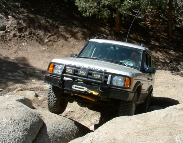

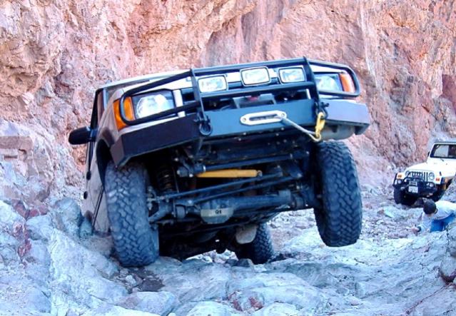

Here is a picture of my truck with a 3" OME lift and 265"s.
With a shorter lift you can get buy with just an adjustable pan hard rod, rebuild the front drive shaft if it hasn't been done before. Ad to that, if you really want to make a crawler out of it, diff guards, sliders and gears with lockers to give you back a lot of low end torque when going to 265's, about 1.5 MPG lose with out gears.
