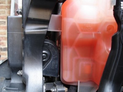

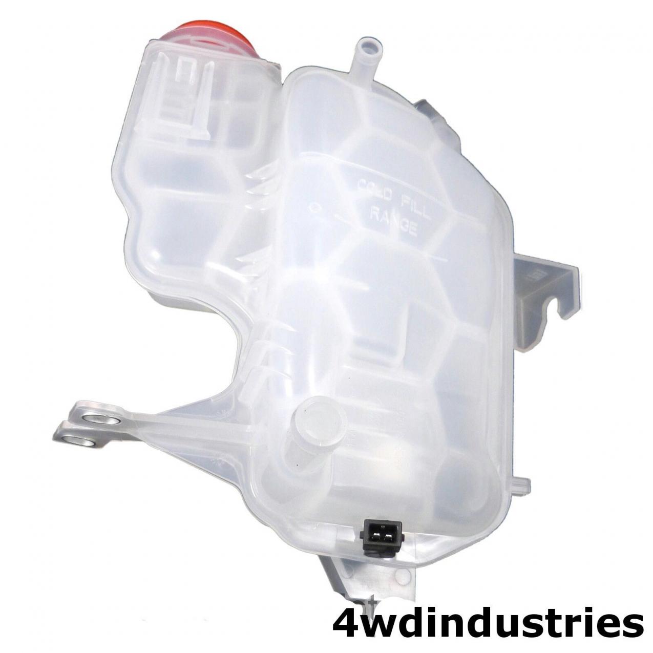

Regarding the coolant, I guess the real question is what is the coolant level in the coolant tank? If it is low, then it should perhaps be topped up. Per the jpg's attached, there is a low level line molded into the plastic.
Usually when the engine is cold, the tank level can be low and after a run, the level is higher, however you are I presume getting a low level message or am i reading your post wrong? When asking for help, the more specific you are, the better it is for you.
As to if the coolant message is related to the tranny shifting concern, it is difficult to say as more often than not on the 3, problems are interrelated.

I guess the low coolant message is just the soaked float problem so that is solvable by yourself - replace the tank assembly complete and you get a new float.

I replaced my coolant reservoir tank two weeks ago and it went swimmingly. There is a great video to follow here. You'll need this tank and the cap that is currently on your tank. I'd recommend a nice long vice grips, I've also found that useful for getting into tight places like the rear valve block.
http://www.roverparts.com/Parts/LR020367
There are two different tanks possible to purchase. The $125 version is simply the original, while the $60 version is the aftermarket. Best of luck.
