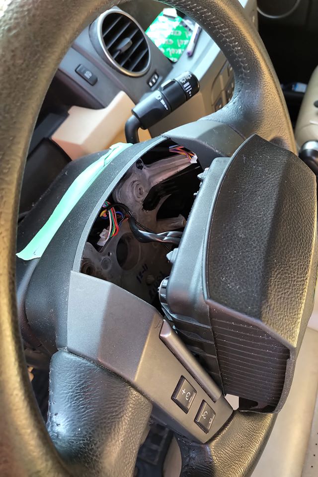

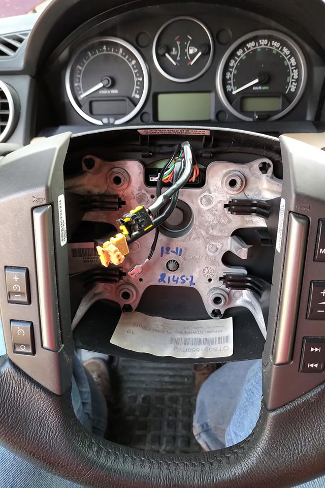

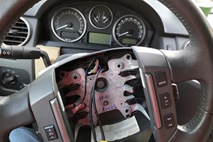

I did remove the clock spring which was surprisingly easy, if not intimidating. The scary part was forcing the bag back in. It took some good pushing to get it to click back in place. Was frightened I'd set it off.
