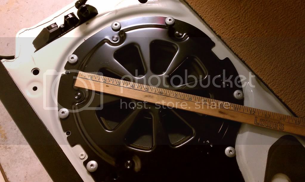

J.D. Yes the sub is in the tailgate. I'd say it's a 10". Basically a free-air setup. No baffles or enclosure per say, just the whole tailgate. Here's a pic i took of it when I repaired the notorious liftgate cable problem...

I have a 2006 Land Rover LR3 and I think the previous owner took out the subwoofer because there doesn't seem to be any base when the music is playing. Where would it be located (if there was one) and where is the best place to get a replacement if it is missing?
DirtKurt
Aug 6, 2010
I did a custom setup in the tailgate with a pioneer shallow mount 10, the stock mounting plate is useless. I fabbed a new mount out of 3/16 aluminum plate it was a tight fit but worked. I did some dynamat inside the tailgate and need to do some more but the sound is still excellent. I also had to add a amp, was able to hide it under the false floor (5 passenger). Overall I couldnt be happier results, 100% percent stock appearance with drastically improved sound.
