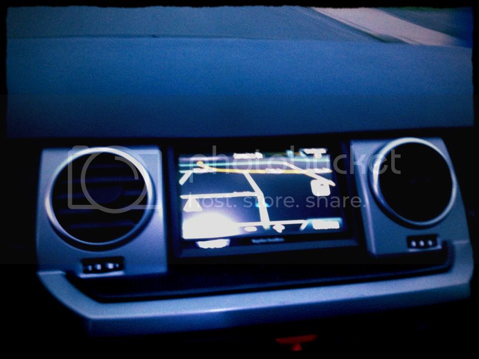

Very nice! I'm interested in how the GPS is set up, any photos?
Voodor35
Feb 23, 2013
You can pick one up at best buy for around $200. I got the lr4 surround trim to make it look nice and flush. Do a little bit of trimming to get it to fit and wire it to the power outlet hiding the cables behind the dash surround. Simple and works great.

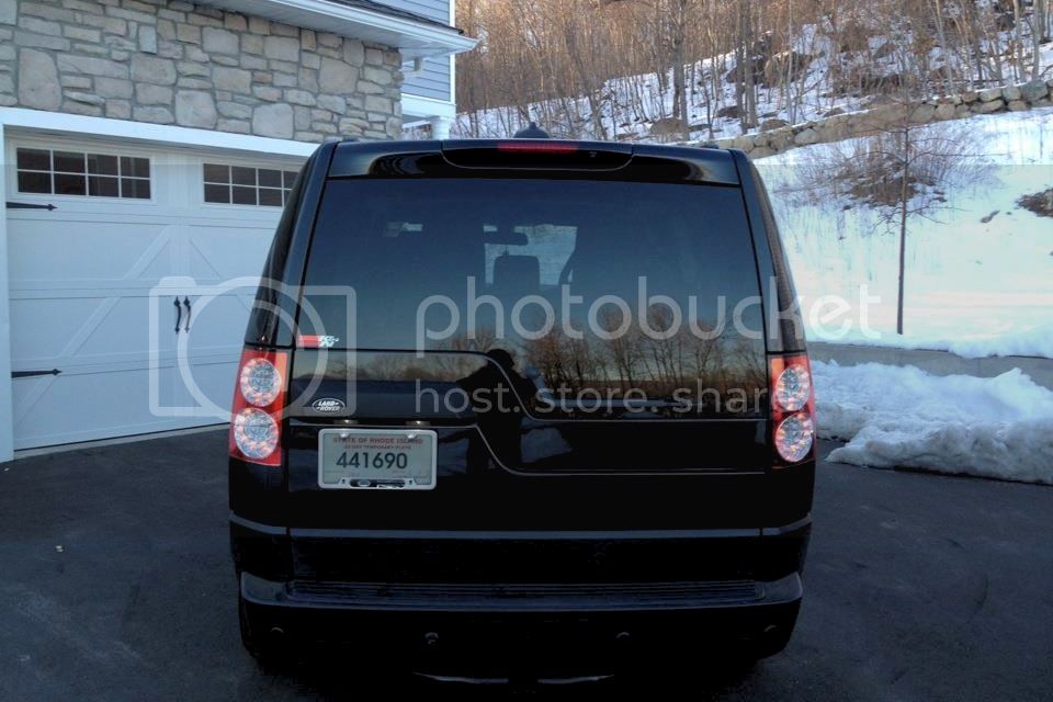

They are factory lr4. I simply replaced the reverse fog and park bulbs inside them to LEDs and tinted the lower portion of the lights. If you do get them just make sure you solder in resistors so your blinkers inside the car can blink at a stock slow interval since without them they will tick tick really fast when you put your blinkers on. Thanks
