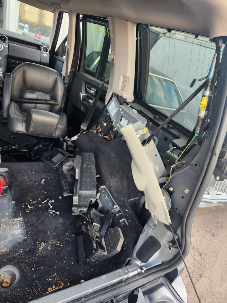

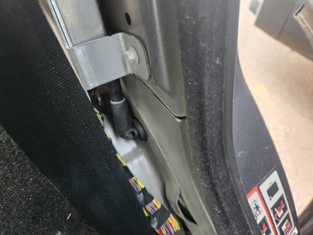

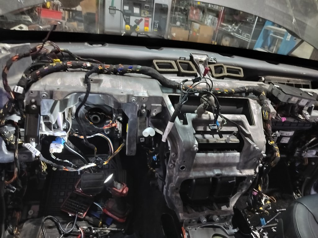

Started tearing into the interior. I found out why there was water in door window sills. Both drains were torn.

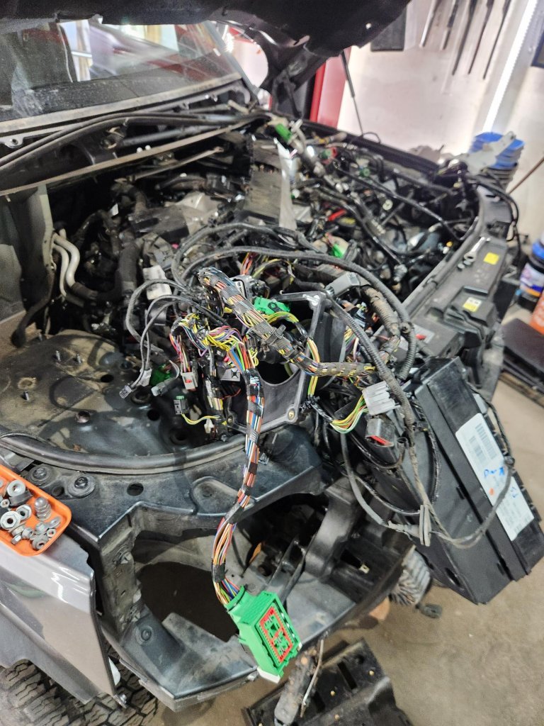

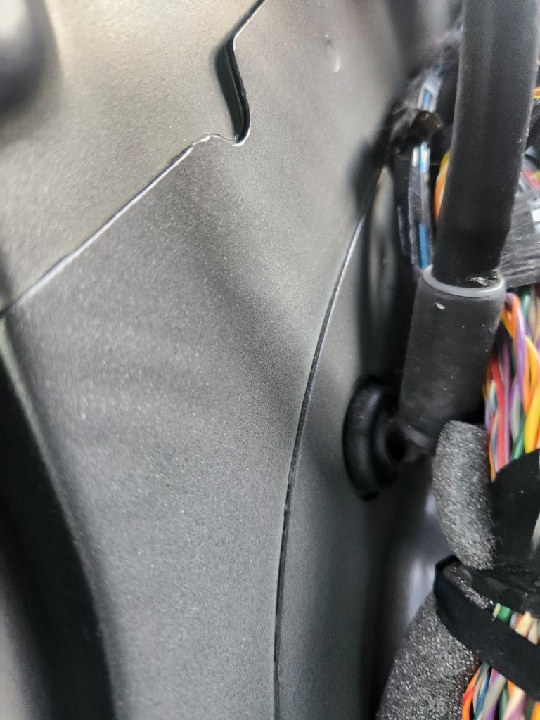

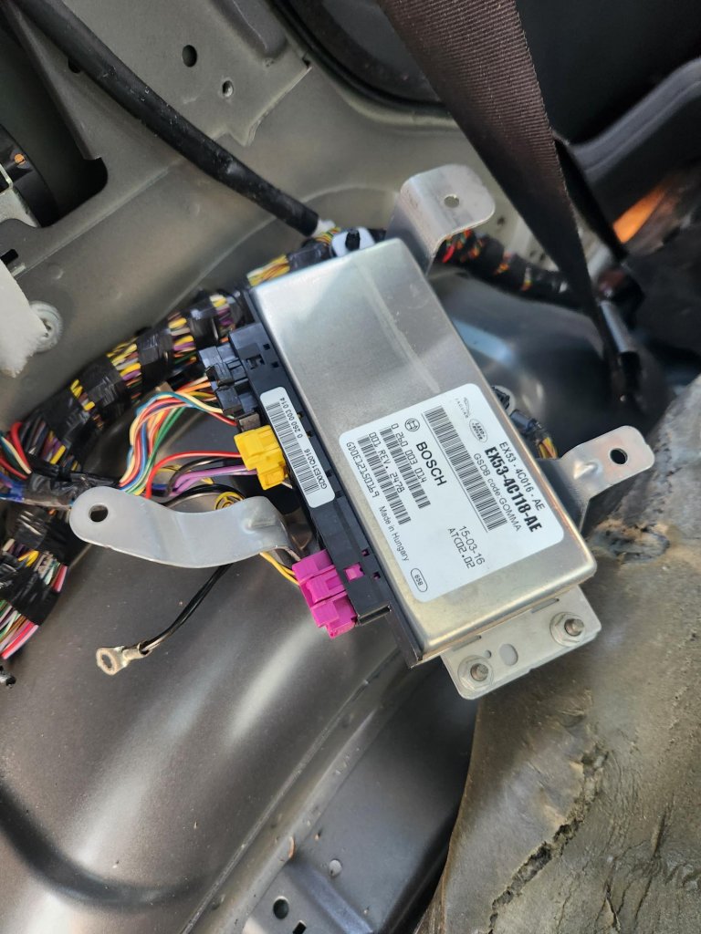

Found the locking diff module

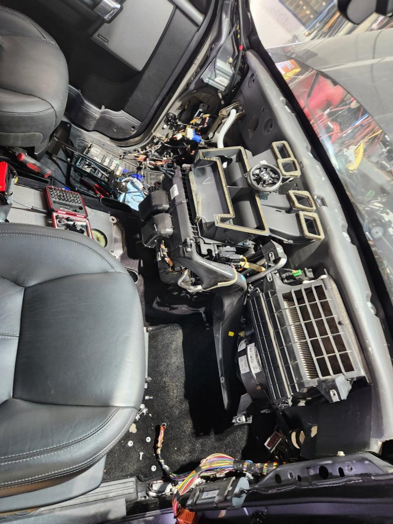

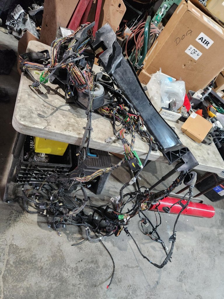

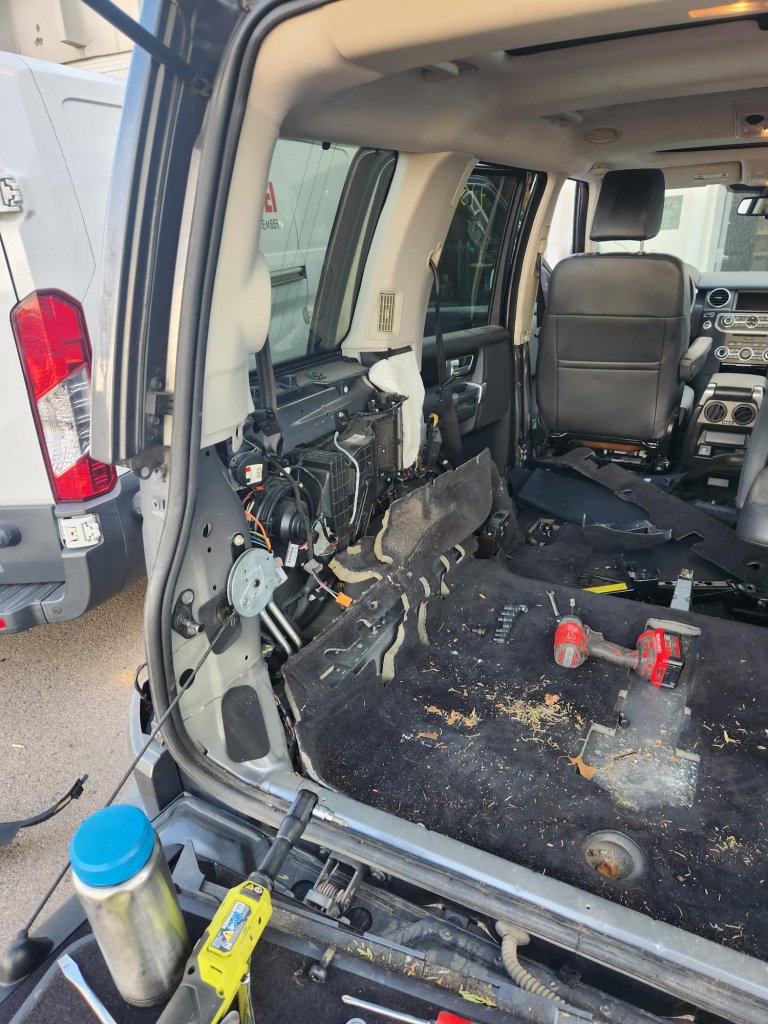

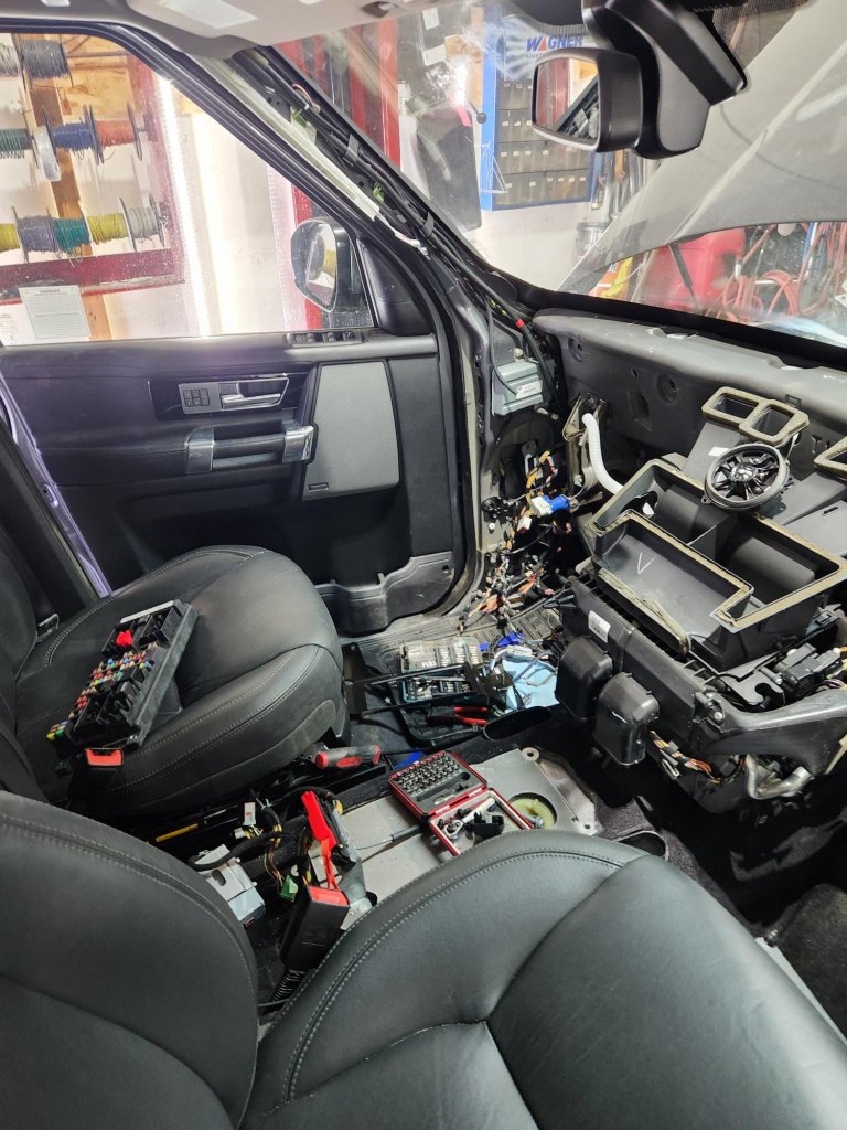

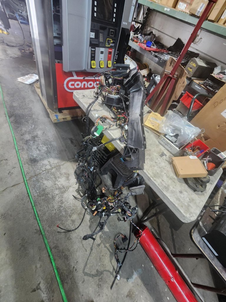

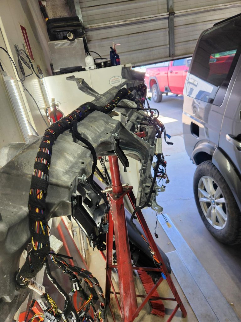

Completed swapping the wiring harnesses & physical parts. The plugs for the locking diff module were already in my harness which was nice. This saved me from having to swap the whole interior harness that runs into the head liner.

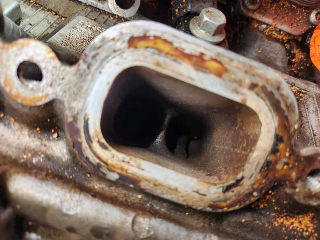

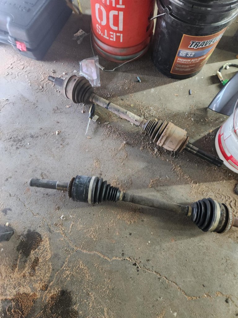

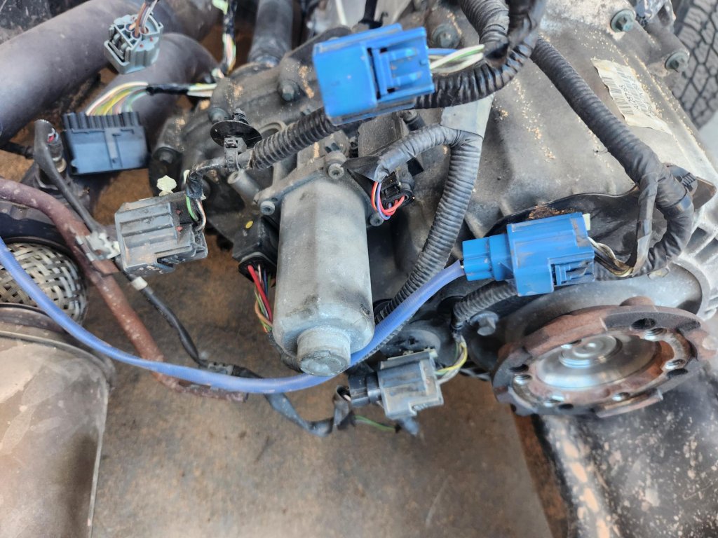

Decided to walnut blast the valves and replace some coolant hoses as well. And spark plugs. You can see the HD vs non hd rear axle here
