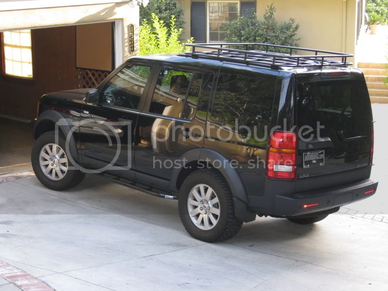

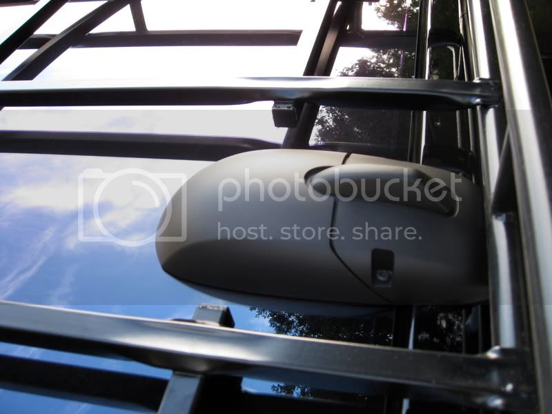

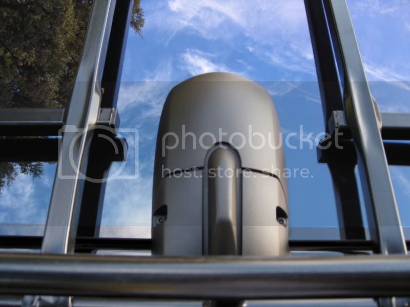

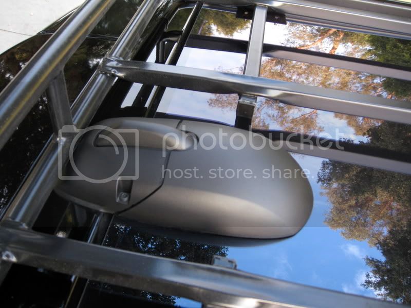

OK, here's my version of the Brownchurch Rack Mod to get around the Satellite Antenna. Piece of cake - hat tip to duckdive for talking me through it.
After cutting the one piece out, I took the piece down to the local hardward store and got a furniture plug that fit the size exactly to finish it off and protect from rust. Prior to putting the plugs in, I treated the inside edge with Rustoleum, then used some silicone sealant before putting the plugs in to seal the edges. Came out pretty clean looking I think. Here's a couple pics.

Nice work. You might want to squirt some silicone sealant into those bar ends and then reinsert the plastic caps to be safe (against moisture or wind turbulence sucking the caps back out).
That rack is interestingly made, with the crimped tube connections and cross bar attachments.
Have you thought about flooring for it?
