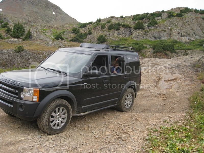

OK, here's my version of the Brownchurch Rack Mod to get around the Satellite Antenna. Piece of cake - hat tip to duckdive for talking me through it.
After cutting the one piece out, I took the piece down to the local hardward store and got a furniture plug that fit the size exactly to finish it off and protect from rust. Prior to putting the plugs in, I treated the inside edge with Rustoleum, then used some silicone sealant before putting the plugs in to seal the edges. Came out pretty clean looking I think. Here's a couple pics.

The only downside on the Brownchurch was the wind noise. It was considerable and I wasn't looking forward to my 1000 mile drive to Colorado. However, it turned out to be a simple fix. I bought a 44" Thule wind deflector from REI, and now it's like it's not even up there. Can't hear a thing. And I think it actually looks pretty good too. Here's a pic.

I like it, does it get in the way of the sunroof at all?

Just a little. Tilt mode is fine obviously. But you can't open it back all the way with the wind deflector down. I don't really drive with it open at full speed though. At trail speeds, wind noise isn't really a factor, in which case I would just flip back the wind deflector into the rack and open the sun roof all the way.
