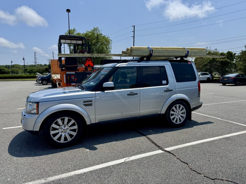

Thule and Yakima both have load stops for their crossbars you can use for lumber. I have basic Yakima round bars and the load stops.

Plenty of fat guys in roof tents driving these, that’s 5-600lbs parked. I’ve had 300lbs+ of lumber on my Yakima bars multiple times.
