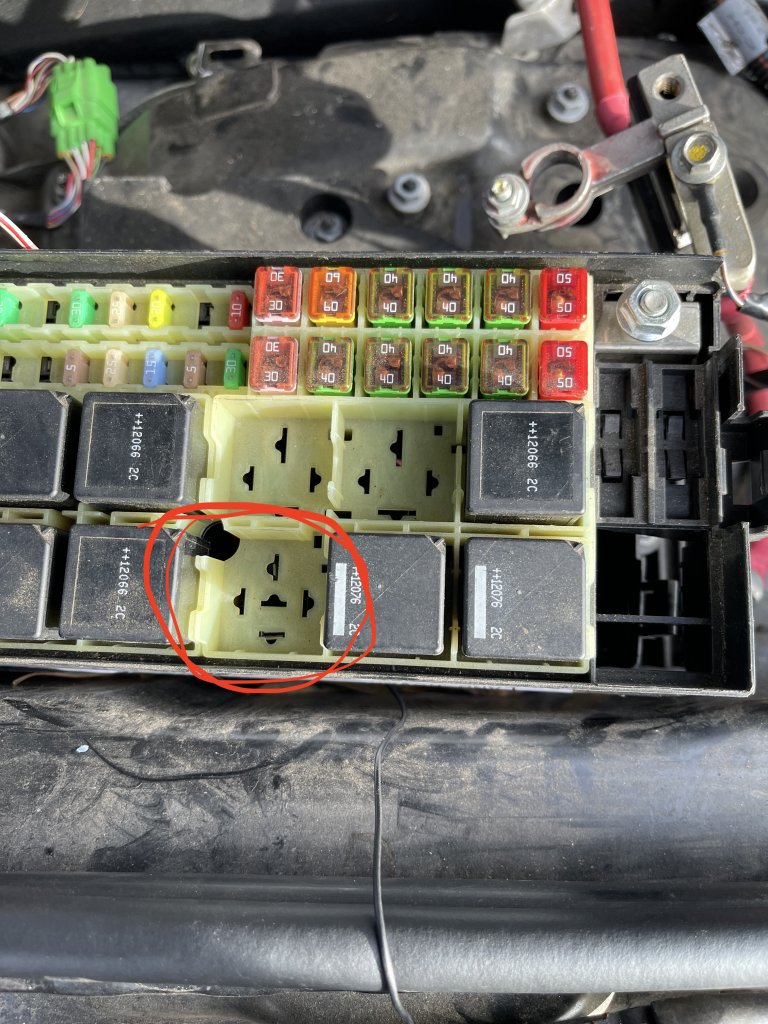

Ok, here's where the relay goes in the CJB:

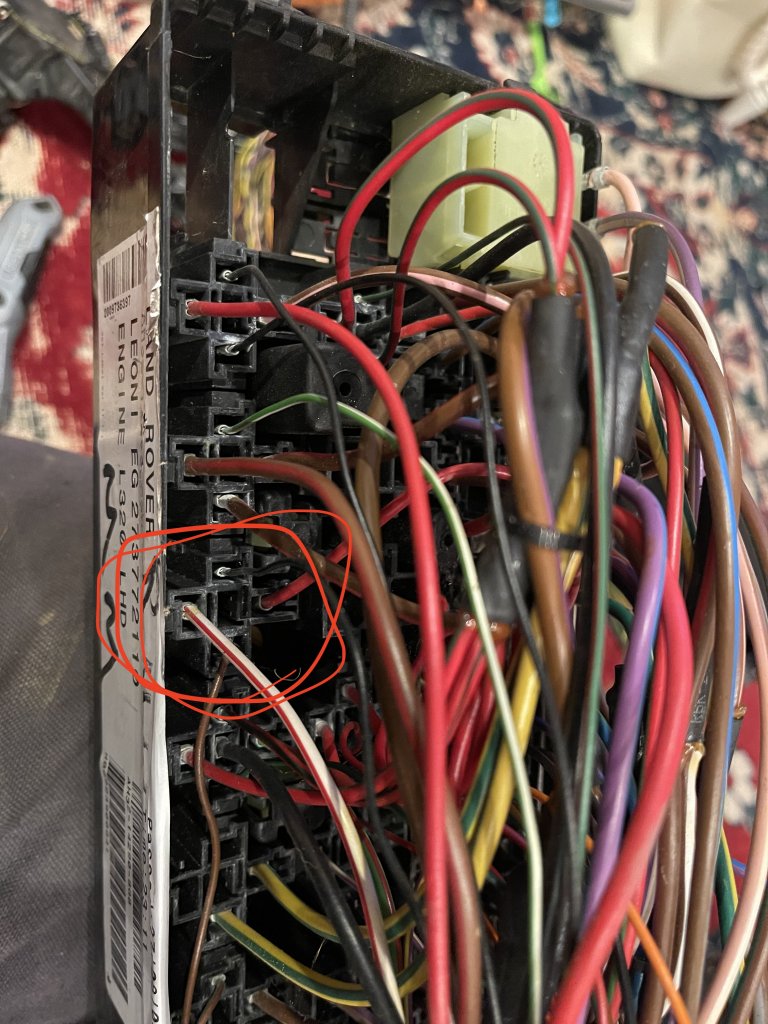

Here's the back, so you can see what wire goes where:
Finally, here's the ground point. I used the top one as it was sitting there empty, but in theory you could use either.

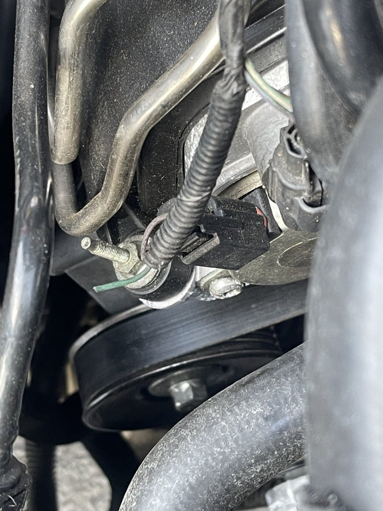

-I found one of the wires on the right bank exhaust VVT solenoid had broken off. All my spare engine harness parts are in storage, so now I have to find a pigtail somewhere. or I guess I could get a new solenoid and upgrade to the new style connector. (Had to swap the intake solenoids on my 2010 and found out half way through the swap). Either way a pain in the rear, and potentially costly.
