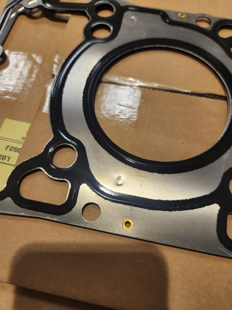

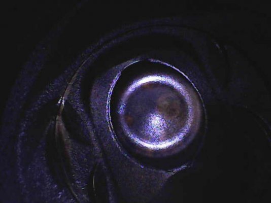

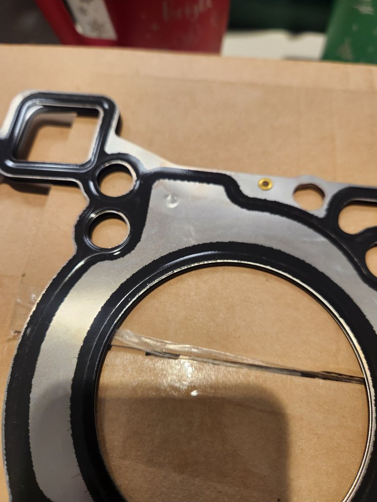

Agree with Powershift in that aluminum blocks and heads do not handle running above normal temps for hardly any length of time and the coating on the MLS head gasket gives way and the coolant makes its way into the cylinder chamber. They sometimes fail right away and sometimes it's delayed. Purchased a used 14 RRS w 99K which had evidence of being overheated by the previous owner and took a chance and ended up having to replace the head gasket at 120K this past December. Since you already pulled the valve covers and injectors doing a cylinder head pressure check would require reinstalling those, but the other thing you can do is use a scope to inspect the tops of the cylinders and see if there is any evidence of the cylinder being "steam cleaned" with coolant. Since it overheated and you're that far into it, pulling the heads and replacing the MLS head gaskets is good to consider depending on how long it ran above temp. If you do make the decision to replace the head gaskets, I highly recommend going with LR Dealer head gaskets; in my vehicle they have specific indentions that appear like staple imprints in random places and are not flaws but engineered for maintaining a stable seal at temp.
