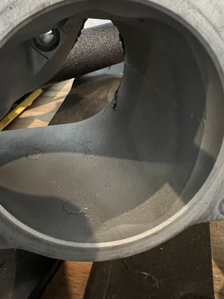

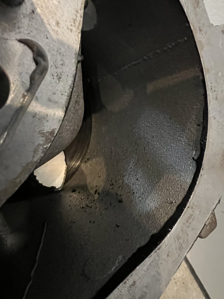

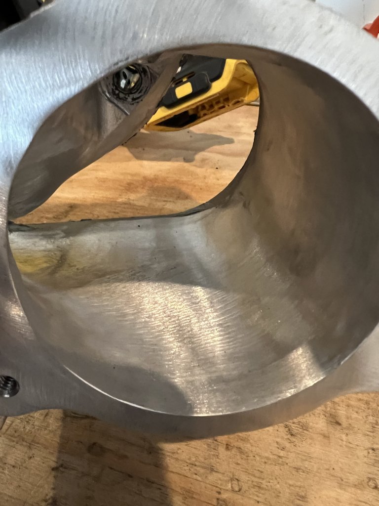

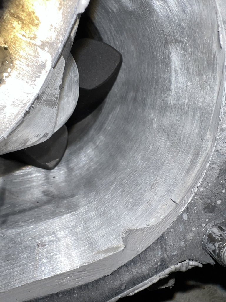

-Sent my spare supercharger off to Jokerz to be rebuilt and ported; Jokerz is now the exclusive partner to Velocity AP for JLR superchargers so everything has to go through VAP, but will be done by Jokerz. Turn around time was about 3 weeks. I'll post some pics, but you cant visually see much difference. Also got my tune updated as there is a little more HP thats able to be pulled out after the porting. Brett at Jokerz was great, and the fact that VAP co-signs on his work I think speaks volumes.

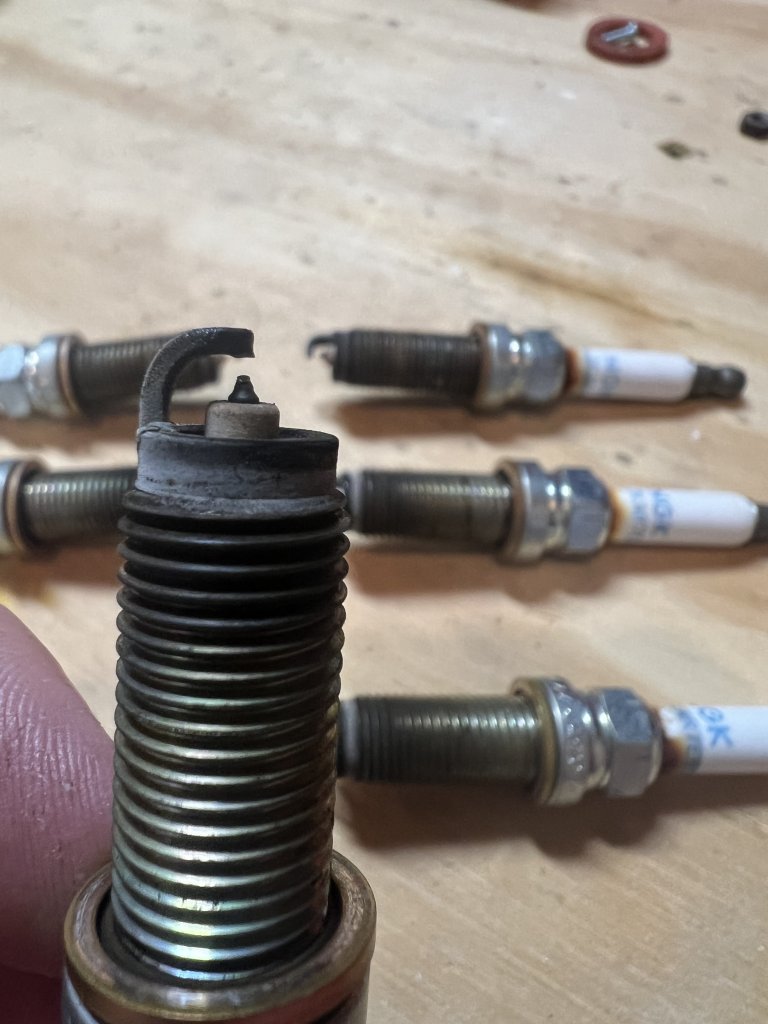

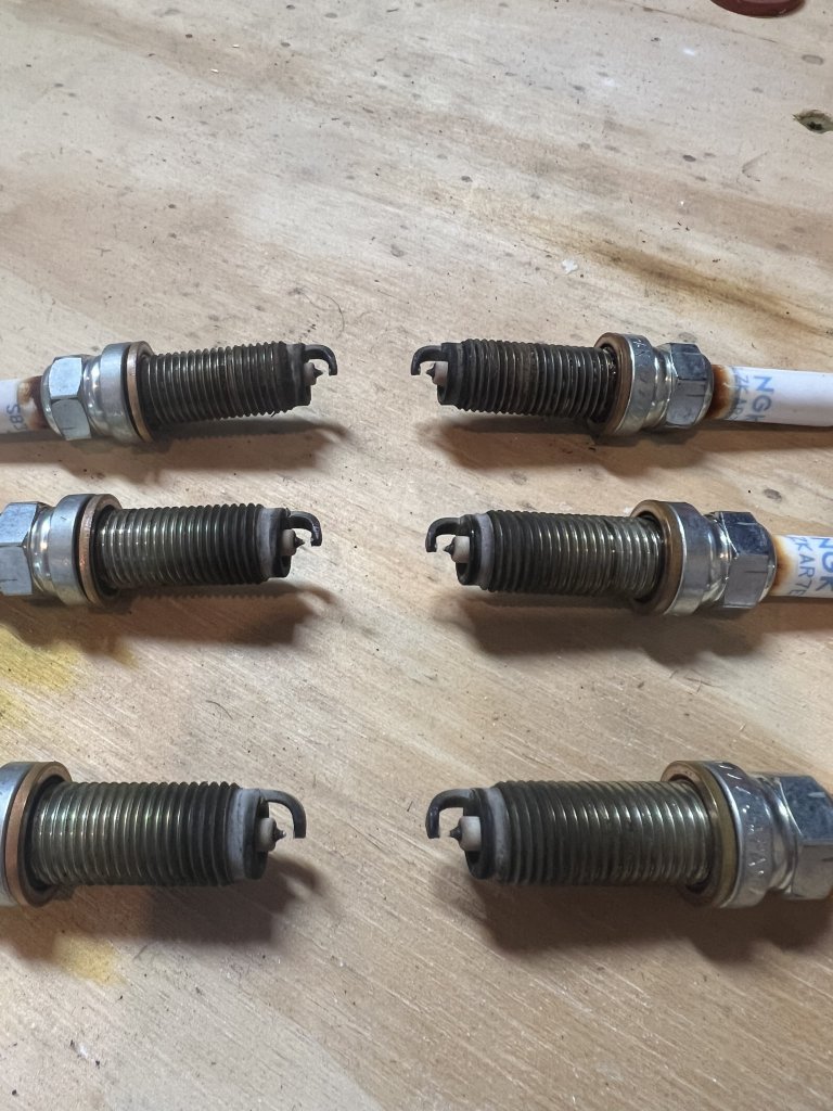

-Still working on spark plugs and then buttoning everything up
