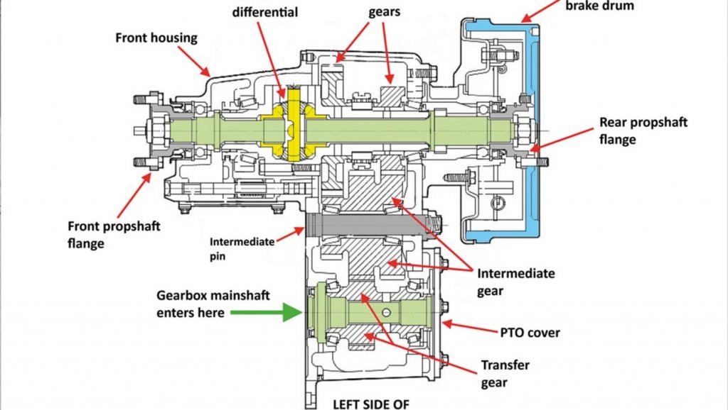

Congrats on the D90! The round cover at the top rear of the transfer case is the power take off cover. It is above the oil level and easy to remove and clean up. Oil splashes up to the top in order to lube the input gear. When you open it, you will see the tail end of that gear.
Here’s a picture:
More pics in this article:
The most common leak point on that I have experienced is the intermediate shaft o-ring. That leak will show up at the front of the transfer case between the transfer case and the transmission. On the picture above, the location is indicated by “Intermediate pin”.
