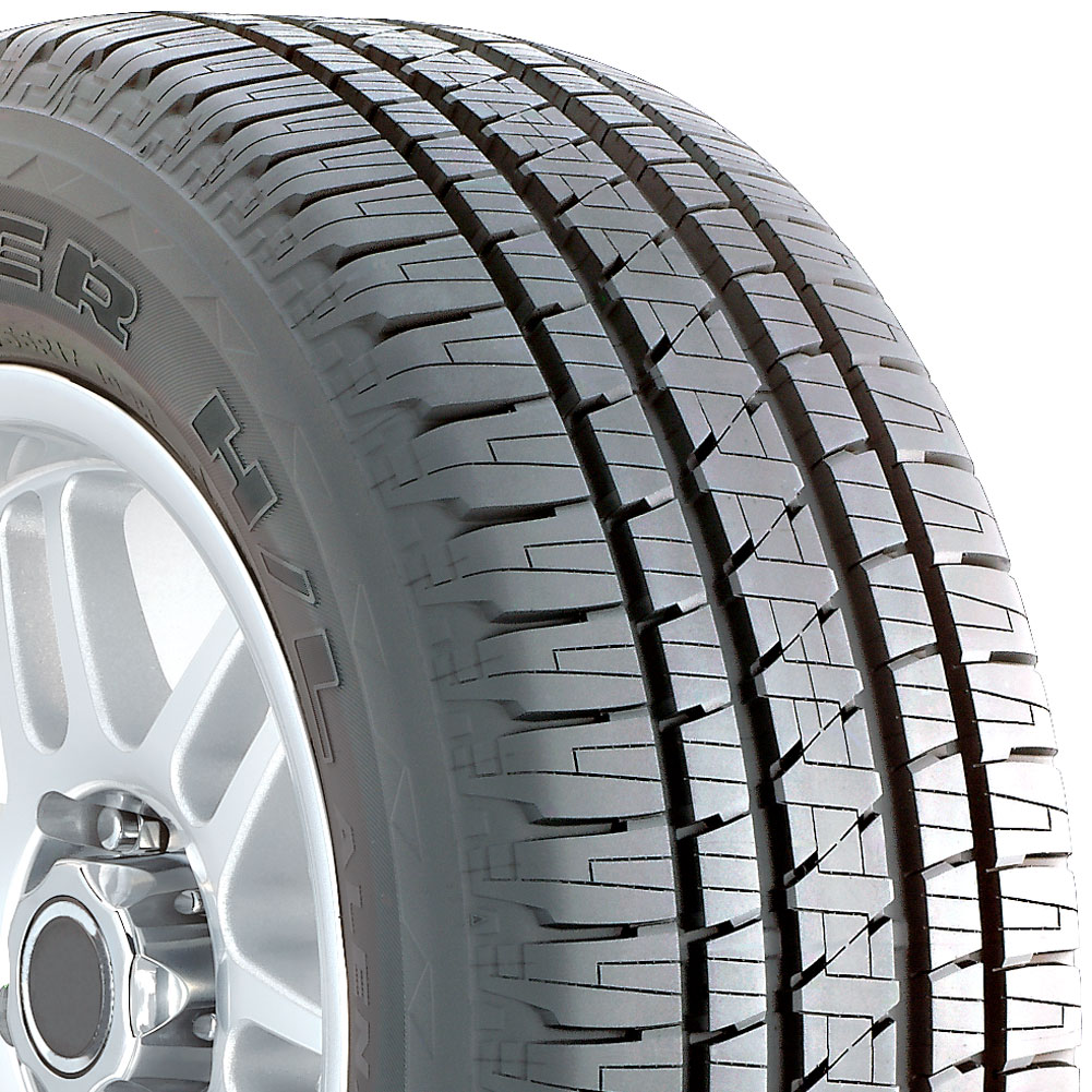

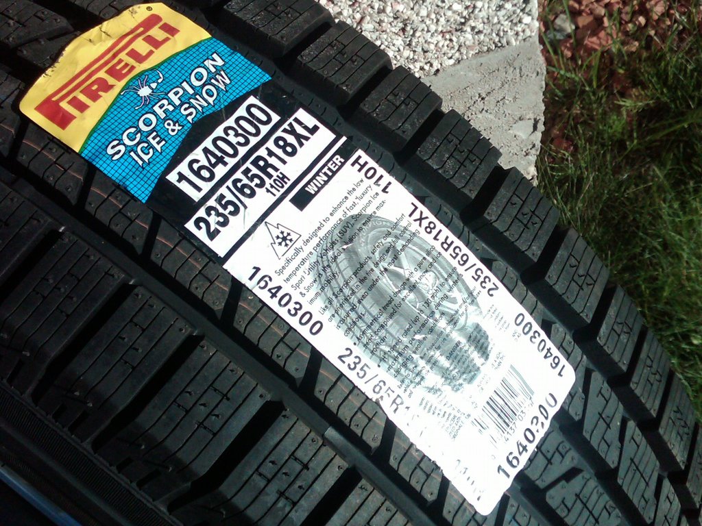

Bridgestone Dueler Alenza H L 255 55 R19 111V XL tread and side brirh6_xl.jpg Pirelli Ice & Snow 235 65 R18 XL 110H tyre sticker and tread.JPG I regard the Bridgestone Dueler Alenza H/L as a summer tyre. I put a set of 19" on about four years ago and as summer tyres, are very happy with them and would purchase them again.
For winter, I have 18" Pirelli Ice & Snow 235 65 R18XL, 110H, a narrower tyre than the 19" 255 55 R19 111V XL Duelers. These I regard as an ice tyre, rather than pure snow tyre. They seem to work for me as my goal is to stay on the road, not go off road.

Nice, those look good. Since I wanted to get away from an all season/summer tire, the Bridgestones were not the ones for me.
