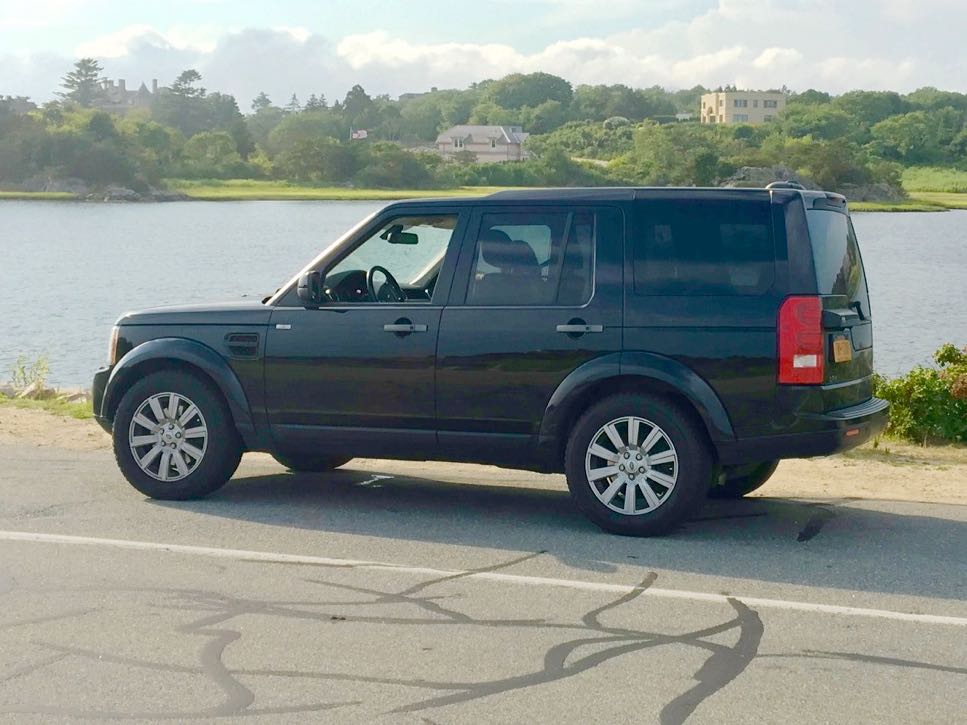

The center bore is the same no difference. I dont know about lr3 lr4 height differences. I do know that the 255/55/20 wheel/tire combo from the newer ROvers is a NICE addition to an LR4. I tried the RRS wide 9.5 rims with a 275/50/20 tire and did not like as much. Anyone looking for a bargin can easily find new 20 RR wheels/tires (255/55/20) for under 1K and bolt on and dont rub and look great on the LR4... offset is 1/4 more aggressive and the tire is an inch taller.
They look nice on the LR4, nice set up!!!
Those wheels are form the RR Sport not the full size RR, correct? I have 19" wheels with 255/60-19 witch are 31" diameter, same as your 255/55-20. The 31" fills the look of the wheel wells way better imo. The only thing I don't like about mine is that the tires sits a little too "in" for my taste...seeing yours with the extra 1/4 offset seem to stick out just right. I originally wanted to get a set of OEM 20" wheels from the LR4 and install 285/50-20 to get the extra width by the wheel well but your set up might work also. Do you have a picture from the back to see the stance?
Quick question, did you had to replace the TPMS with your original ones or the ones form the RRs work with the LR4? Thanks!
