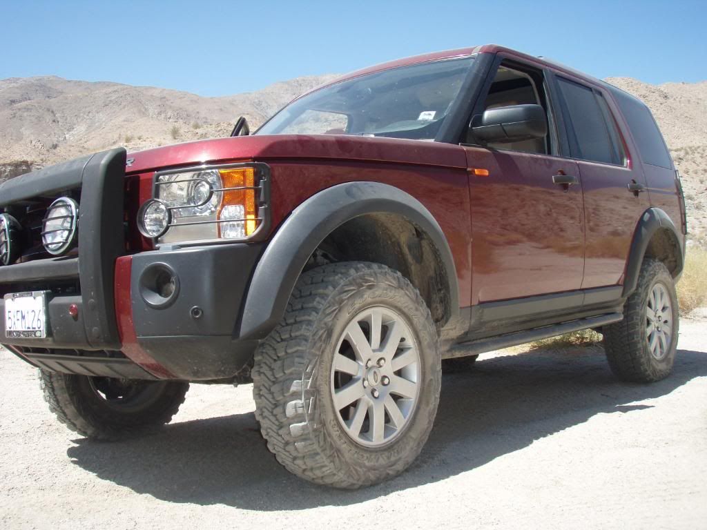

Yes, I like the Good Year Silent Armor for an AT and the MTR for a more aggressive tire. The kevlar side wall adds stability and prevents pinch flats. I have a complete list of available tires here on my tire size chart page :

Definitely better than the HP, which I can't mange to post a picture of :mad:

Johnson Rod Tires
These are the tires I run. Good Year MTR 275-65-18 32 inch diameter. I believe these to be the best off road tire. For the LR4 I would try to get 18 inch rims from the UK if possible or go to 20 inch for more options.
