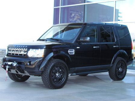

Sorry it took so long, I was traveling. Chad Manz, a fellow AZLRO member, took these photos of my 2010 LR4 LUX HSE HD with Compomotive 18 inch wheels and BF Goodrich 265/65-18 tires. Check out the winch and skid plate! See www.azlro.org for the article. (sorry my photos are so huge! Couldn't figure out how to reduce the pixel size)

Those tires look AWESOME!!! Wow! I love them!

Here is the wheel
Joanne
Apr 30, 2011
12
Another photo. Sorry so small. I had to reduce the file size. See www.azlro.org for my full article on the wheels and tires.
