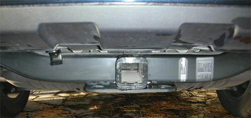

Narrowed down my choices to either the Curt Tow Hitch or the OEM accessory KNB500080. My problem with the LR Tow Hitch is the fact that it does not have holes for the safety chains, is that not mandatory in the US? For those who are using this part, how or where do you attach the hooks for the safety chains?
I have also noticed a Tow Bar in a photo that was posted on the British Part of Utah site and was wondering if anyone knows where this Tow Bar came from? You can find the link here http://www.bputah.com/Parts/hitchcover2.jpg

Besides cost, are you not able to achieve the same with the OEM part? I need to use the safety chains for my trailer given its size and that is why unless there is a solution for the LR3 part, I would have to go with the Curt. The one showing in the photo I posted does not appear to be made by Curt, but it does appear to have been installed on a Range Rover.

After getting under my car, I found that there are two holes in the OEM bumper for the chains, I can use those or the ones that come with the Curt Hitch.
