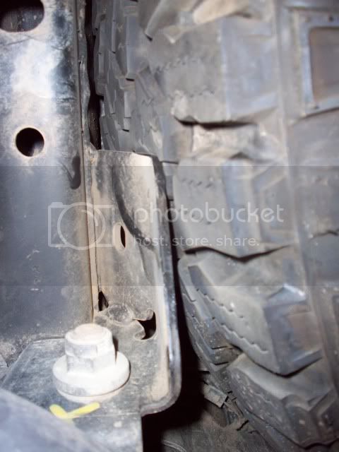

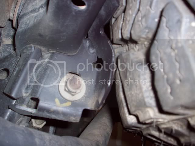

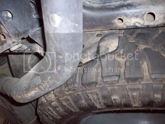

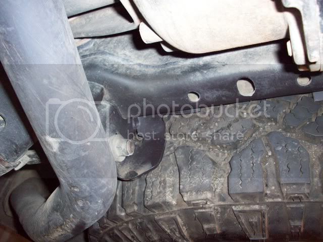

I've been thinking about this since I had my sidewall blow-out on the trail this summer. I literally had to use some WD and my prybar to get the spare out. It's just too tight in there with the deep DuraTrac tread - even at 2psi. I finally got around to some strategic notching to allow more space. The tread had to deform against this bracket at least 1" to fit. Not good. My son was the Fire Marshall with the extinguisher ready as I started the spark shower. First I used a cutting wheel then finished it with a 40 grit flap wheel. Primed and sprayed with some high temp that I had laying around. Spare fits 100% better now. Still snug, but there is no longer any deformation in the tire - it even sits a little bit higher in the pocket.

Good work, thought about doing something similar.:beer:
