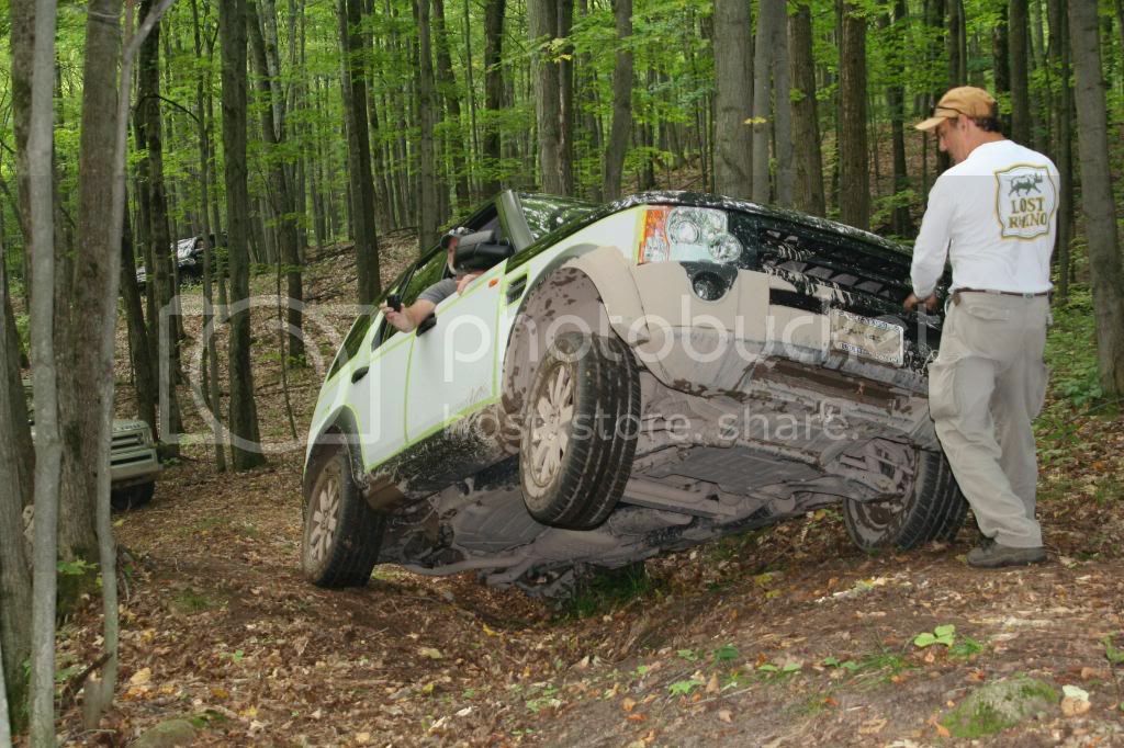

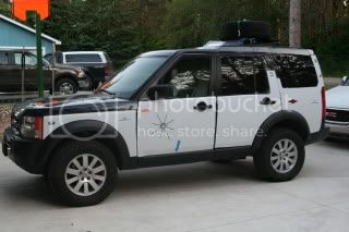

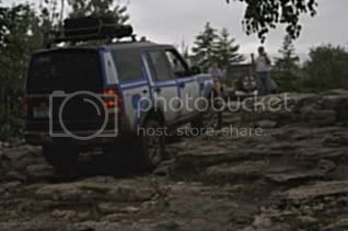

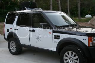

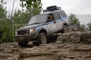

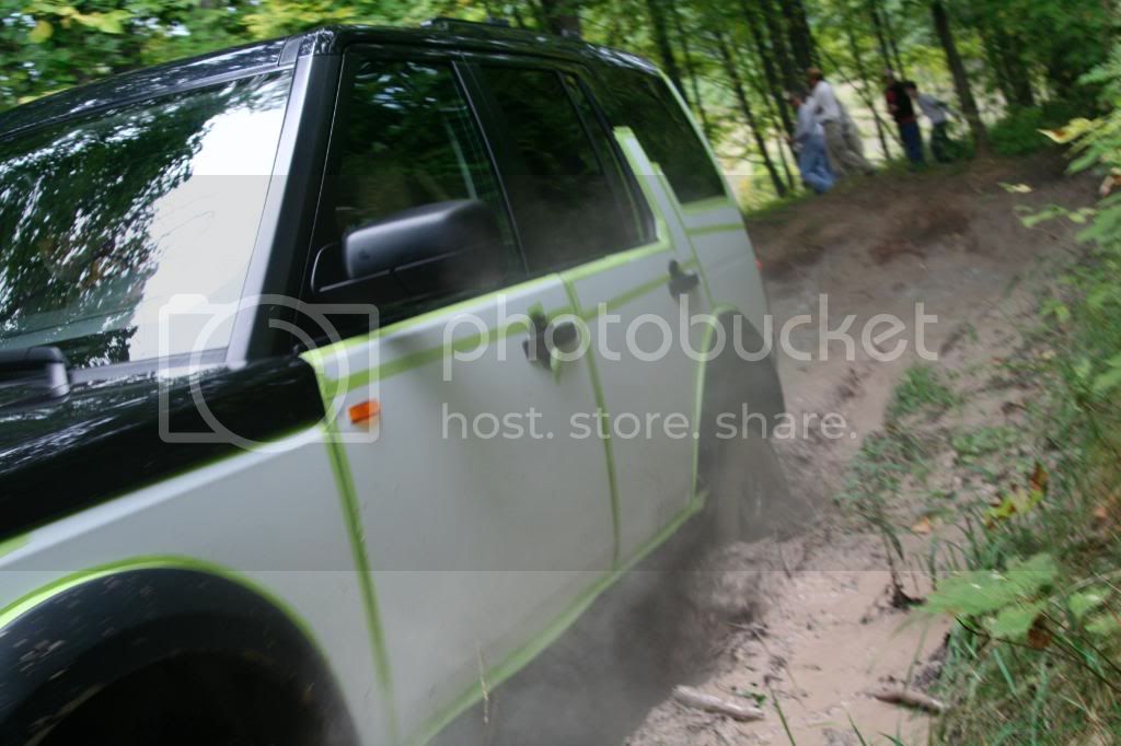

You mean like this
drzjoint
Jul 26, 2008
625
sorry I got carried away I just figured how to get photos to come up easly
The tape allows you to go 90mphh with out it comming off you want a CLEAN surface to put it on so you dont want to throw it on at the trail head. I t also prvents branches from catching it and pealing it off
If you want I can make you a set off mine. If you want me to

Dr, how long does it take you to put that on before you go out? How much for a set?
drzjoint
Jul 26, 2008
625
All taped down about 30mins

Dr Z-
I like it. It looks like one of their 'base' colors is green, so I would try and match my exterior a little closer than the alpine white panels you have. : )
Do you remember what size roll you started with? Or where you sourced the materials?
drzjoint
Jul 26, 2008
625
I got my roll from a local sign shop. I think it was a 2x50ft roll . You will also need a large roll of 4ft paper of a bunch of card board to make up templates for the panels. You get to make it twice once with the template and then again on the vinyl and then trim trim trim. You only have to do one side. I went with white since it was cheaper. so I am slowly putting stickers and such on. Just painted the kids hands on there doors. It is kind of fun to customize. Use a heat gun to mold around panels and creases. You have to tape it down or it will all fly off. I use 1.5" and 2" masking tape 3m high quality the cheap stuff stinks.
