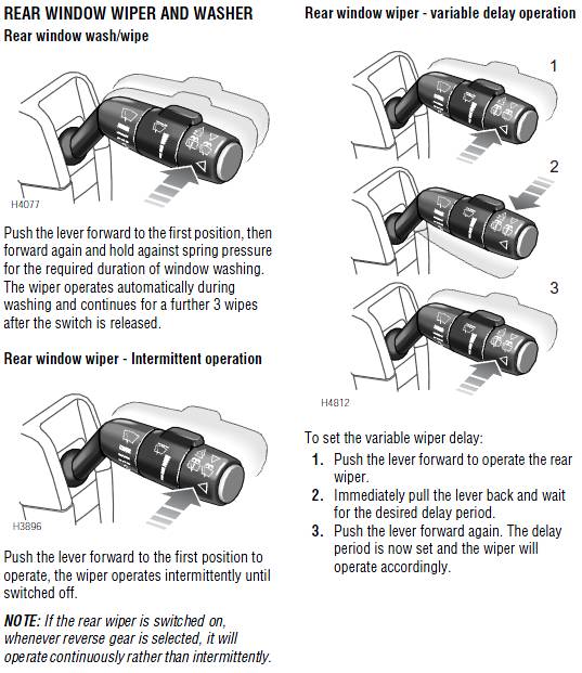

Hi All,
Picked up a Ranger Rover from a friend kind of a try before you buy deal. Don't want
To sound like a total idiot but where is the control for the rear wiper. Seems to be working
Intermittently and I can't shut it off. Thought it might be controlled by the lever on the steering column if so what position is off.
Thanks

need more info, year of the RR in question. Normally it is in the center console above the radio IIRC.
joey
Custom Rover Accessories
Staff member
Jun 28, 2004
10,495
188
Not sure if this is the same or not... latest online manual I have is for the 04 MY RR.
