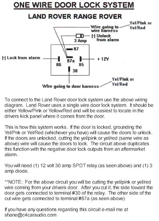

If it locks or unlock when connected (but not connected to the linkage) then it maybe the linkage is locked up, if it doesn't even move then... there may be an issue with the used one, or you may have a wiring issue.... I think I may have a wiring diagram, but not sure.
joey
Custom Rover Accessories
Staff member
Jun 28, 2004
10,495
188
Hope this helps.
