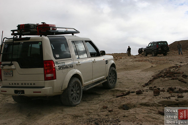

These aren't great photos, but they show my rear recovery point with shackle installed:
nwoods
Apr 27, 2006
1,675
Top photo is the tail end of Nightmare Gulch.
Photos: http://blog.nextstepdesigns.com/?cat=24

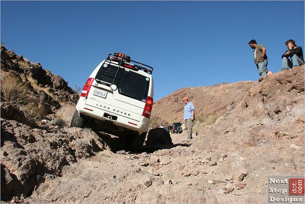

The bottom photo is one the Doran Canyon trail in the Odessa/Calico area. Probably the knarliest trail I've done in the LR3 so far.
Photos: http://blog.nextstepdesigns.com/?cat=25
...both of these are in Southern California.
