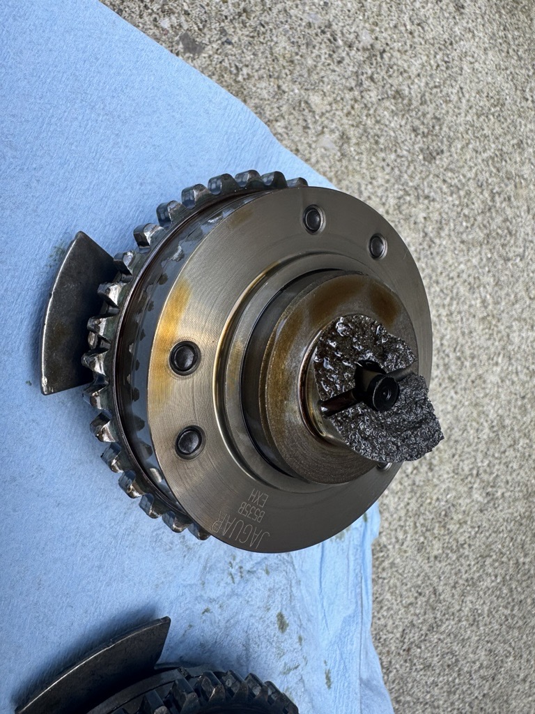

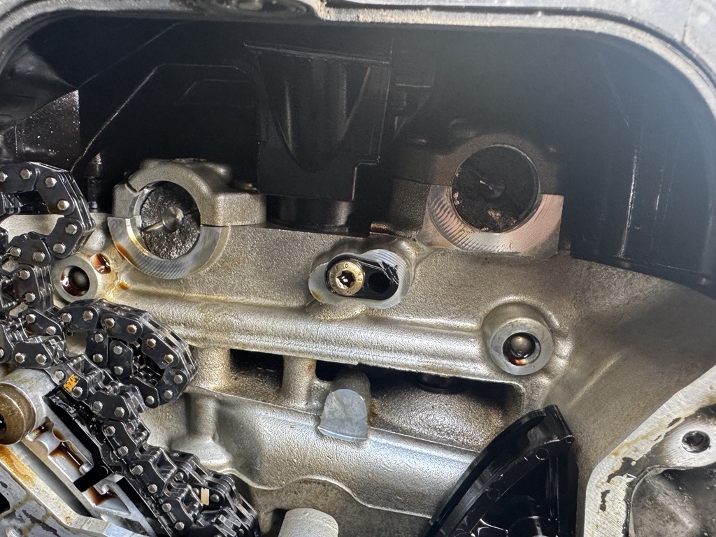

Makes me think that something went wrong during the timing chain job.

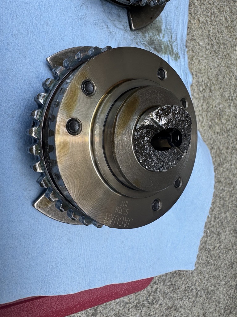

That is my year. I would be asking the shop that did your chain questions and check the warranty because that shouldn't happen. Maybe they overtorqued the mounting bolt and that weakened the camshaft where the bolt goes through the cam-to-actuator mounting point. Thats what the evidence shows because the cam breaks are right there where the fastener is.

i did the timing chain myself.
i used the proper torques specs. the torques spec was like 30 NM or so. so not that wild
my car has a flooded title due to a leaking windshield. not worth the investment, so I'm on the market for a different LR4
