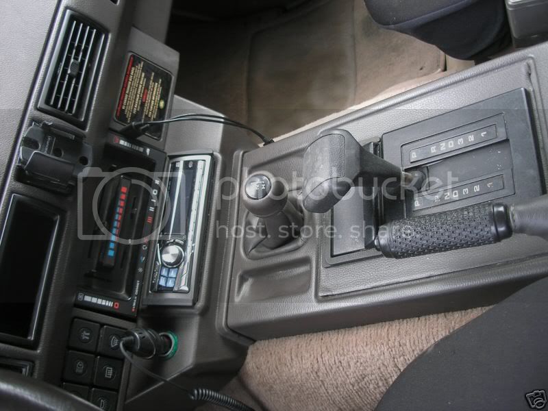

Also, what does the button in the top right corner next to the heating controls( above the rear window defrost), mean?

The button is the cruise control on/off button.
