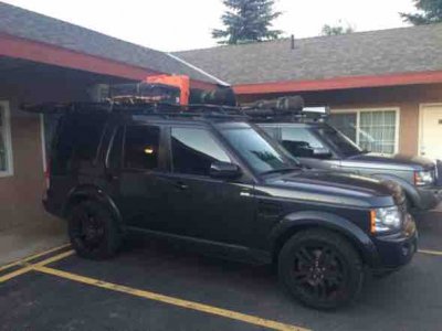

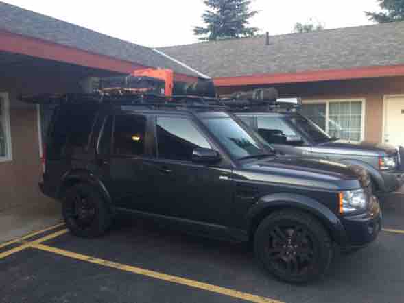

I put the Nitto Tera Grappler G2's on our 20's and they have been awesome on and off road. Quiet on road and took on a week in the Oregon backcountry no issue. I didn't even air down. ImageUploadedByTapatalk1440556577.876085.jpg

Ya those look pretty awesome.
