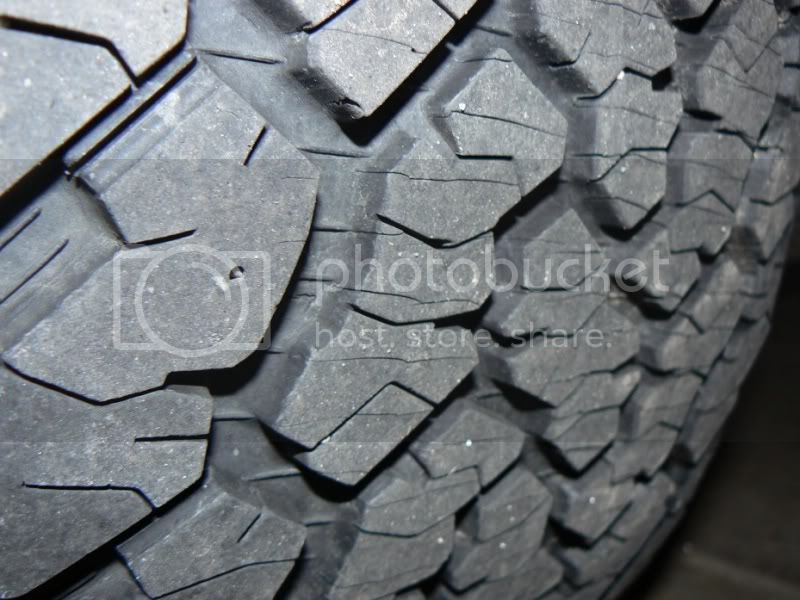

toddjb122

Thanks, Rich. Any pictures of the tires? (post-siping)

Hey toddjb122 - sorry it took me a few days to follow up. Here is a quick picture of the siping - it has actually opened up quite a bit from when we had it done (which I heard it would do). When it was first done, you couldn't even really see it - now it is pretty apparent. Notice it is just a "straight" cut, and only on the inside part of the tire (not on the outside lugs). I could definitely see how it would possibly increase "chunking" if you were doing a lot of rock crawling off road, but I would also think it would help in mud.
We are still pretty happy - went up and cut down a Christmas tree today, and had no problems on the ice/slush.

Thanks Rich (I had to remember to re-read this from home because photobucket is blocked from work). Anyway, that isn't at all what I expected siping to be. So, a picture is worth a 1000 words for sure.
