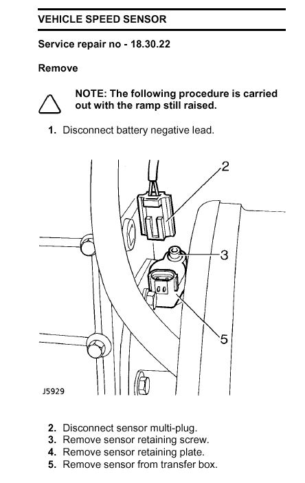

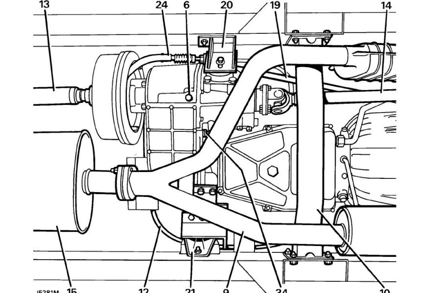

My 96 engine might be configured differently. Perhaps if you could be more specific about the location (front left, right rear, under...etc) or post a picture/drawing. Then I can switch it and see if that solves the problem.
I don't know where my transfer case is or what it looks like.

Vehicle speed sensor
The vehicle speed sensor is located on the transfer
box behind the transmission brake. The unit has a
multirole as the vehicle electronic speedometer
sensor and as a sensor for ’surge damping’, (a
function which smooths out engine response to sharp
accelerator movement and reduces vehicle ’bucking’).
The sensor is an additional input for engine overheat
protection.

Use two 6" 3/8" extensions, a ratchet, and a 3/16" Allen driver to get to it. It's super-easy to DIY. Just make sure the square drive in the VSS fits into the square socket on the transfer case.
