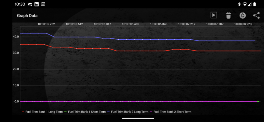

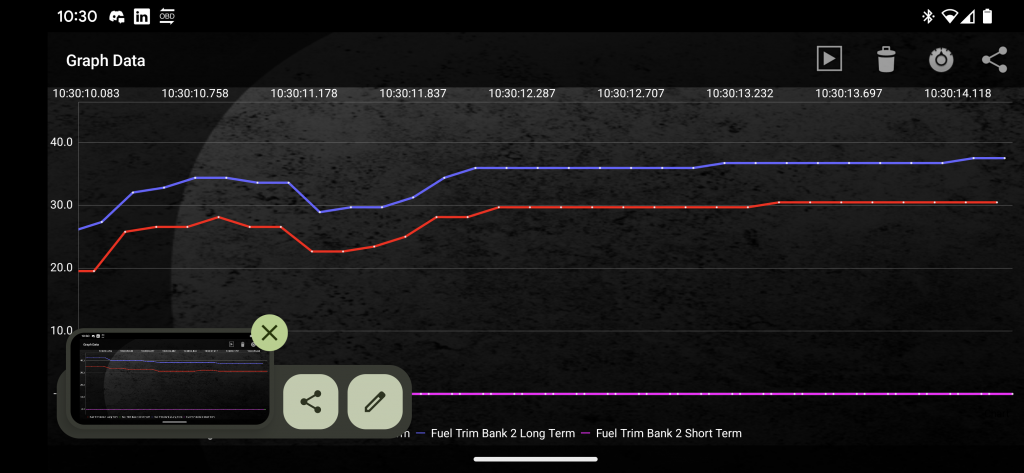

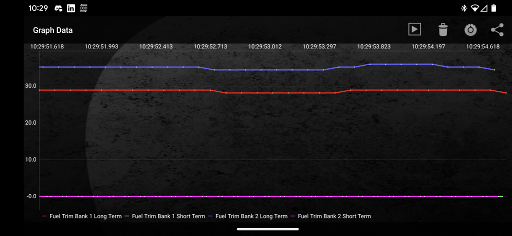

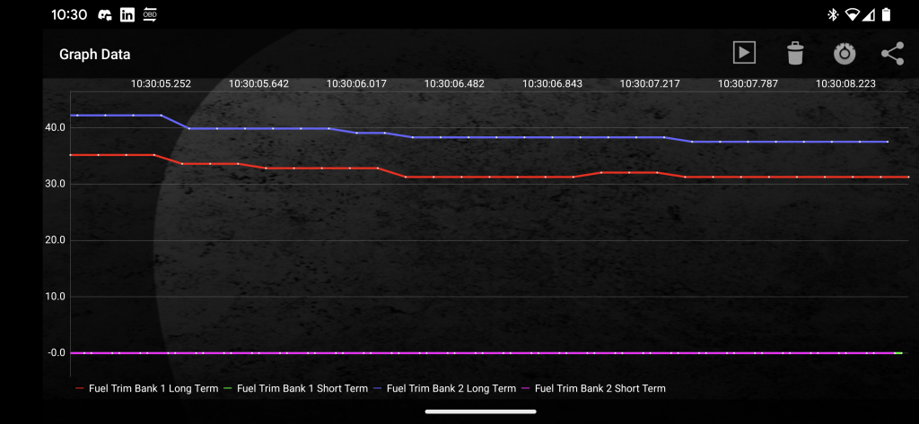

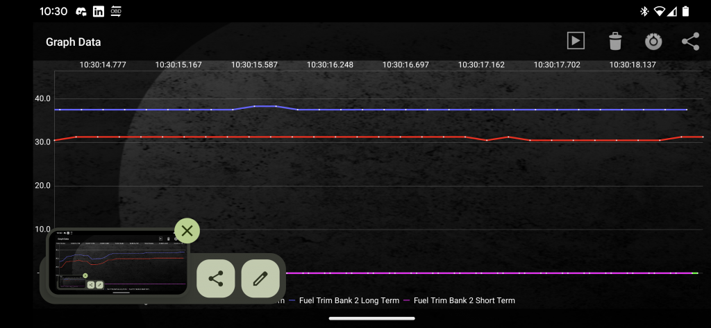

Changed coil packs on 4 and 5 from donor engine and no change, checked sparkplug on 4 and looked ok so while running I started tugging at the harness and noticed a change in idle so I followed the ground and noticed it was loose enough for the ground to wiggle around. Probably why it misfired that first time while putting the engine cover on and for the bump to wiggle it. Tightened it and misfire is till there. I wonder if there all that messed up injectors 4 and 5 so I got new seals in the way and I guess I'll replace the injectors with donor ones. Did look at fuel trims and they look good to me but idk y'all let me know how they look.

Here's come of the screenshots

I’m not sure what I’m looking at in those graphs. If that‘s showing 30% to 40% (or -30% to -40%) on the fuel trims, that is not good by a long shot. You should be throwing codes at that level. Am I reading it wrong?
