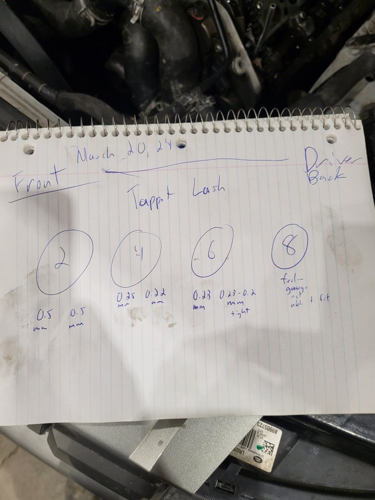

Pulled valve cover to measure valve lash and looks like we may be onto something here. Tappets were marked when removed from the engine but seem to have been put in front to back instead of back to front.
Cylinder 2 tappets have clearance of 0.5 mm while Cylinder 8 which is misfiring has no clearance. Cylinders 4 & 6 are within spec
I guess this means a bit of a teardown to repair. Will have to set up some weekend to do this job.
Awesome.
The exhaust cam will have to be removed.

Pulled exhaust cam off yesterday and swapped tappets between cylinder 2 & 8. Valve lash was then back in spec and once I fired her up the misfire was gone. Seems like valve lash was my problem the whole time. This one seems solved. Thanks everyone for your help!
