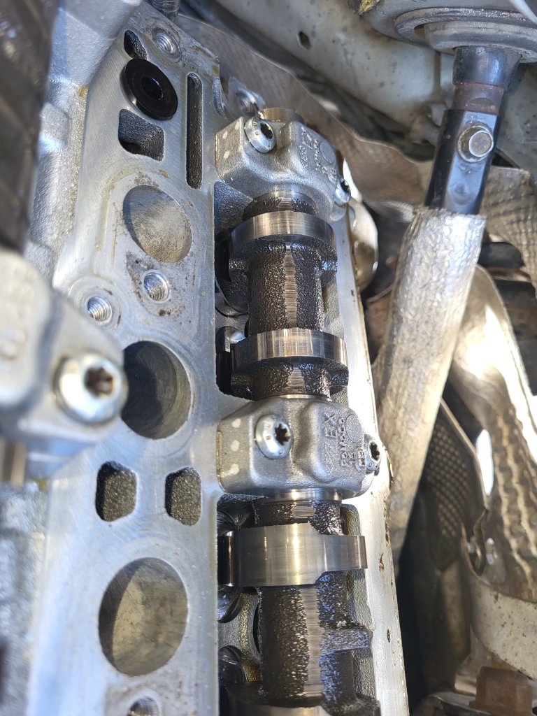

Looked into it today, but seemed to be a dead end.
Is there a possibility that the intake manifold has a crack that only affects one cylinder? Grasping at straws a little here.

ebp02
Oct 21, 2023
17
ATL
Had you messed with the engine bay recently? I had a similar issue on my scv6, left a loose ground on the miss fire head, lil 8mm ground by the cam sensors on the front of the head. Ultimately fried my ecu so I had it cloned. If your missfire comes and goes then maybe loose or broken cable/ ground for the coil pack. Check the wiring with a multimeter to the ECU and to the ground and go from there.
LR4Slavo
Dec 1, 2020
174
81
Denver
I would start with a compression test on the cylinder at this point, might also be beneficial to boroscope the cylinder to see if there's any obvious damage
tvanstee
Mar 9, 2024
14
17
Saskatoon
Misfire seems constant, almost seems to be every other rotation. Cabling and grounding look good. Will have to check compression again
