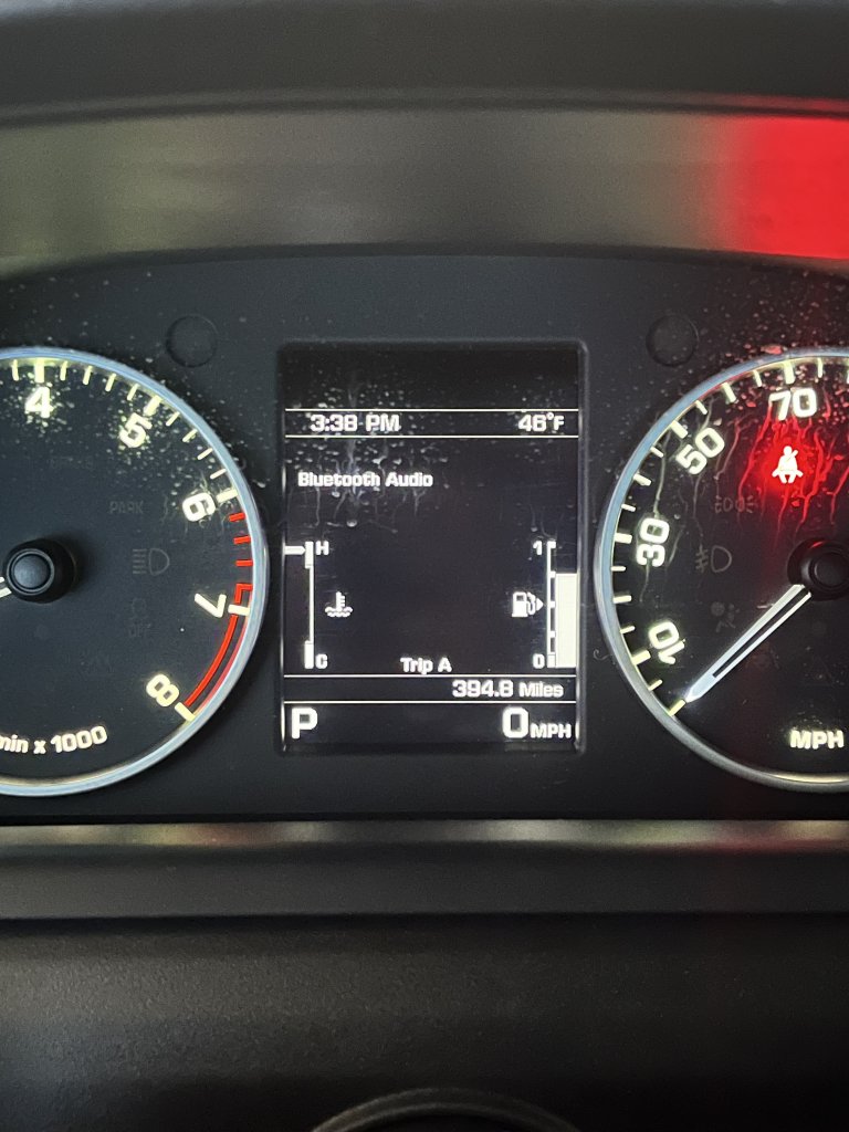

I’ve only put about 200 miles on the vehicle and it’s over heated 5+ times. The overheating will occur after about 20 to 30 minutes of driving and once I accelerate up a hill. The temp gauge will rush up to H and the overheating warning will illuminate. I’ll pull over or let off the gas and the temp gauge will drop down to center.
I’ve hit the engine with a temp gun and the hottest it has registered after an event like this is 200 degrees. It comes from the left side of the front of the engine.
