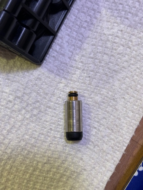

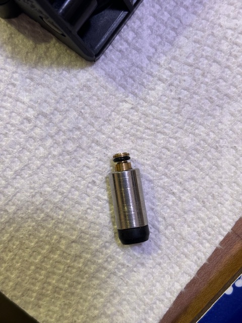

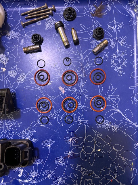

My kit from British parts of Utah came in today, and I'm pleased to report that the kit looks spot on:
Top is the old, bottom is the new.

Wish I could remember to advise you but I don't, as mentioned; the kit worked well, take your time, clean everything up and use a tiny amount of silicon grease to help with the sealing.
