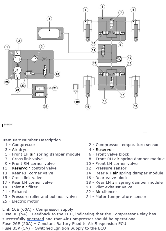

With the fuse out, that eliminates the struts themselves.
You're more that likely looking at the front suspension valve block, has an internal leak. With the fuse in, there may be a stray voltage that cycles the valve block.

It's a little weird that with the fuse out the vehicle stays still, to me this implies that there's not a leak. You see, with the fuse in the vehicle can adjust vehicle height as needed even when it's not operating. Regardless, I would pull the valve block out (it's in the passenger side front wheel liner) and treat the valve to a clean and new seals (there are a number of threads on this forum and also a few good YouTube videos that explain what to do). One issue over time is that silica from the compressor gets in to the seals and causes very small leaks. It's a pretty easy job to do. The same can't be said of the rear valve block (access issues).
I'm wondering if it's something to do with the ride height sensors, could they be somehow misleading the ride ECU during the night? Again, that would be weird given your observations in your second post.

This is what I was thinking. Something electronic is causing things to leak, and the front valve block is really all there is in that regard.

I'm still curious to know what the actual difference is between the front and rear valve blocks - I'm having sagging of the front after my control arm replacement, not sure if it's due to having depressurized the system and some desiccant dust got into the solenoids and are keeping them from closing properly, or if the extended range of motion of the strut sprung a leak. The front valve blocks still show out-of-stock, but the rear is available. I don't have spares to dismantle and compare, but I'm curious to know if you could adapt (perhaps just by changing the connection pins) the rear block to work on the front, or if there are orifice differences or whatnot.

@Longtrail thanks. I may just replace the front valve block as they are not very expensive and just have a brand new one in there. So my assumption (hopefully correct) is that I can just replace the one in the front and hopefully fix the issue. If it does not correct the issue sounds like the last thing to check is the ride height sensors. Thanks all for your thoughts and input on this.
