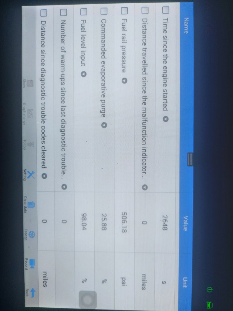

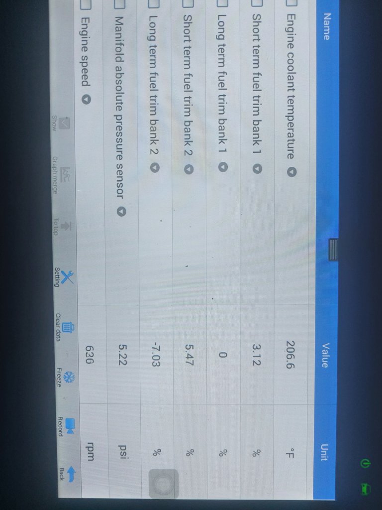

So i got to spend some time today with the reader, after replacing O2 sensor b2s2 + b2s1, which did not fix anything and I later got a CEL with b1s3 as malfunctioning, and got some interesting readings:
FUEL TRIMS
* Bank 1
- stft hovers around +3% and only goes up to a max 10% when around 3000rpm
- ltft is a constant 0%
* Bank 2
- stft starts at +3% at idle and goes down to negative 13% with increasing RPM up to 3000pm
- ltft is around -7%
- fuel rail pressure fluctuates from 510 to 540 psi higher rpm higher pressure
If i understood how fuel trim works correctly, i am in normal lean range for bank 1, but bank 2 is screwed up with an injector stuck open or something else?
I still did not replace O2 sensor b1s1 though...

It’s odd that the two banks are the opposite of one another. I think you are correct that Bank 1 is technically staying within a normal range, but it’s still indicating an increasingly lean condition with increasing RPMs, whereas Bank 2 starts in a normal range (just a little rich) and then gets increasingly richer with increasing RPMs. You are looking at the numbers when holding the throttle steady, correct? You need to hold it steady for a good 15 seconds or so and let the numbers kind of come to rest (more or less). When you accelerate, it kicks out of closed loop, then goes back into closed loop when the throttle is held constant.
Assuming the numbers are correct, is there any chance the wires got mixed up on the o2 sensors? I haven’t changed the o2 sensors on mine yet, so I don’t know what chance there is of it happening. I assume you’d have more codes, but it’s just something that occurred to me so thought I’d mention it.
If the o2 sensors are working and the numbers are correct, I’m not sure what‘s going on. Originally I was thinking maybe an injector, but if you are misfiring on all cylinders in the bank randomly, that doesn’t sound like an injector. Could be a problem with spark I guess. Not sure, gonna need to dwell on this one some more. Two people on this forum had a sheared off bolt on the exhaust manifold, but I don’t think that would cause a rich condition (not entirely sure though). That occurs to me because you did have a motor mount problem in the past, and bad motor mounts can sometimes put stress on the exhaust manifolds (as the engine moves around too much).
