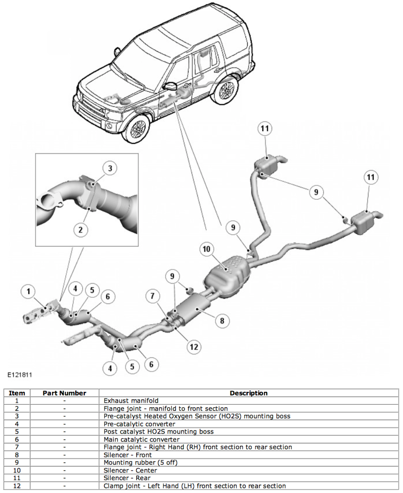

I wonder what exhaust setup it has. We have a whole lot of silencers in ours, front, center and the two little rear ones. Anyone have this diagram for an F-Pace? They probably even have some type of active valve that controls that growl. I know the higher spec models have a button that makes them louder.
I have heard of some folks taking out the #10 center silencer.. aka the 'turtle' (i think thats what i've read)

thanks for the thorough reply. I've considered removing the turtle but the sound clips on Youtube are not good enough for me to consider hacking up the system. I guess I'd have to hear it in person.
Regarding the loaner F-Pace, I did not notice an actuator button for an exhaust type bypass. I like your idea though of an F-Pace diagram for comparison. I suppose I should have climbed under it!
