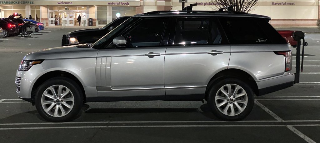

DaveCap
Feb 6, 2020
Staten Island, NY
Sport Hitch will NOT fit the L405.
You will need a VPLGT0083 bumper bar,
LR036694 support bracket and VPLGT0074 harness,VPLGT0097, VPLGB0154, LR090834- under tray, foams, bumper cover, then you will need some 50mm and 40mm bolts. The kit from LRV is around $1300, you can piece together for less.
I just ordered one on ebay that's listed for a sport. On the ad it says it fits both, sport and full size. I need it for my l405. I called roverspot in CA. They claim it will fit. He seemed pretty confident. He says there may be a slight mod or two, but only for the plastic cover. I'm not looking to pull anything heavy. Just a bike carrier or a tray in the back. I'm hoping you're wrong here. Any further input on this? Thank you in advance.

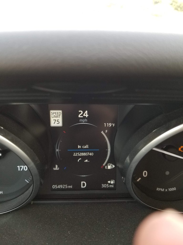

drkbrent
Dec 28, 2019
Baton Rouge
I tow with my ‘17 Sport diesel. 2 4wheelers and 2 dirt bikes is all I’ve ever pulled from LA to CO. I made the mistake of putting in 15w - 40 engine oil...kept overheating once I hit the mountains. I don’t believe the 40wt oil hurt anything...just thinking the sensors/electronics are so damn sensitive that the heavier flow of the oil caused the excess heat which triggered the electronics to throw a code! Haven’t seen the code since going back to the 30wt oil. I’m sure the 119 degree temps outside didn’t help!!

So after installing the bar, if you add the support bracket, can you then tow?
David Vanharen
Mar 25, 2021
pennsylvania
DaveCap,
can you share any additional info on the reciever? I've been searching in vane for one. just need it, like you, for a bike rack on my 2014 range rover thanx Dave
