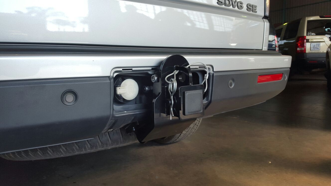

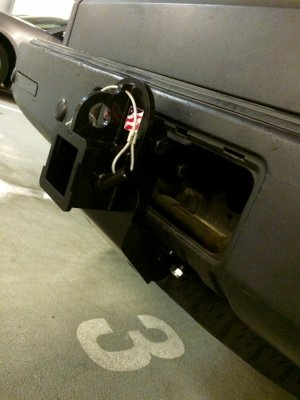

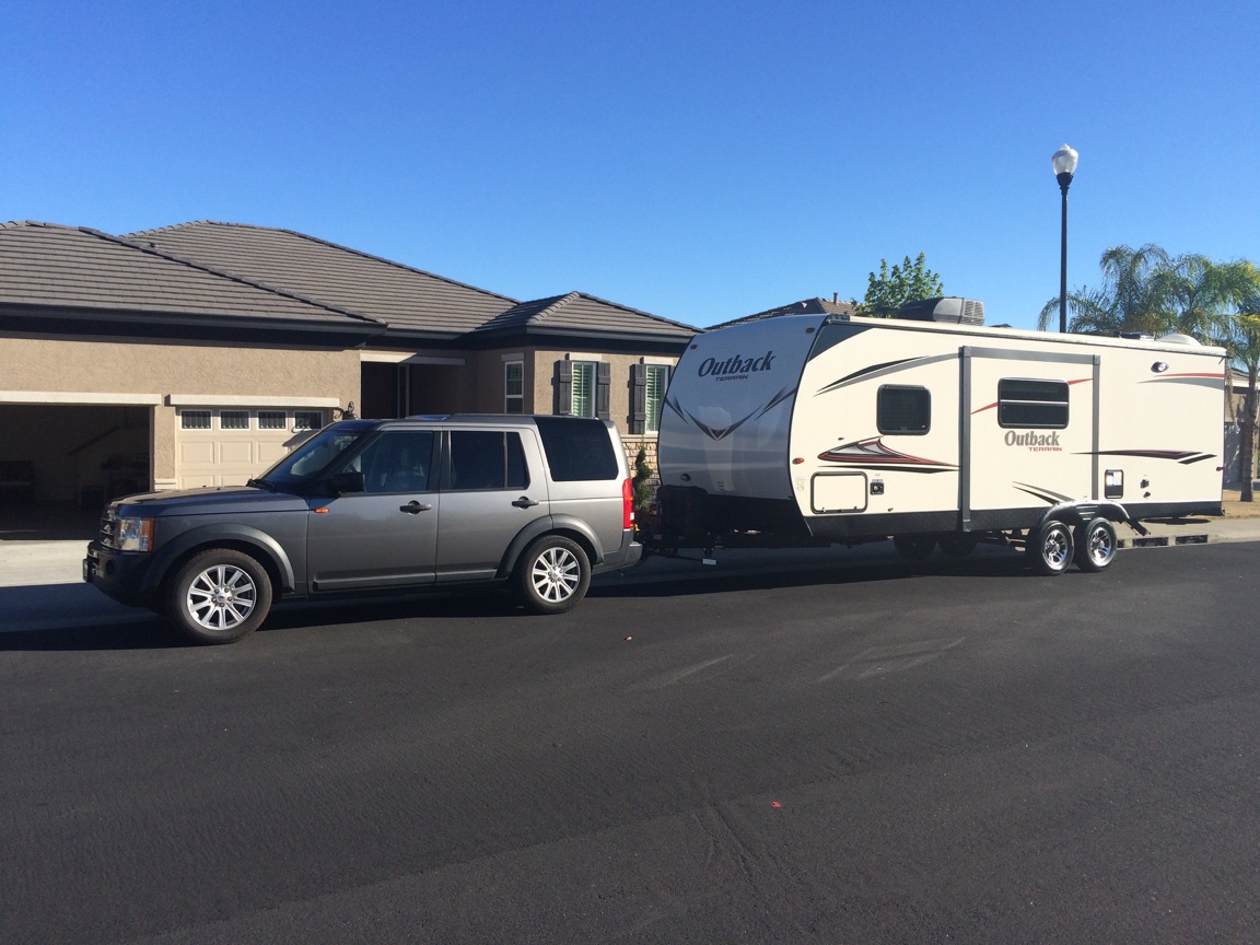

Here are a few pics of Todd's hitch setup (including one of his customers towing with his LR3 and a Reese WDH):

Trailer looks nice, BTW. We, too, are in Colorado. We should compare notes some time. ;-)

Thank you! I agree with you...when I was searching for details on his new hitch (which is extremely new btw...his first shipment of production hitches arrived only a few days ago even though he has been testing pre-production versions over the past 8 months or so), the only web reference that comes up is associated with Rhino hitch steps. With production hitches just arriving, it does not look like the website is fully updated so I will defer to Todd (who has been very responsive to my PM initially, and then email communications after that).
Your concern about the depth of the tow bar is a valid one, especially with the Hensley hitch setup as the WDH configurations tend to be deeper than a standard, non-WDH hitch. My Equalizer WDH requires 3" of depth from the deepest point in the hitch to the center of the retainer pin. I believe the Reese WDH shank requires approximately 4" of depth from the deepest point of the hitch to the center of the retainer pin, and I know that his pre-production tester (shown in my pic above) required a small notch in his Reese hitch shank of approximately 1/4" to clear the attachment at the main frame recovery point to avoid any interference, so I think I've got approx 3/4" additional clearance (but please don't take that as fact until I have a chance to receive my hitch and confirm myself).
I should receive my Rhino Hitch soon and will definitely post up pics and confirm the depth available when it arrives, so stay tuned. I also plan to hook everything up and take some towing test runs prior to the start of our camping trips this summer, so I promise some pics and info on that too.
Glad to meet another fellow Coloradan! Love your towing setup as well! The pics of your setup and trailer inspired me to feel confident in the capabilities of the LR4...would love to compare notes with you.
