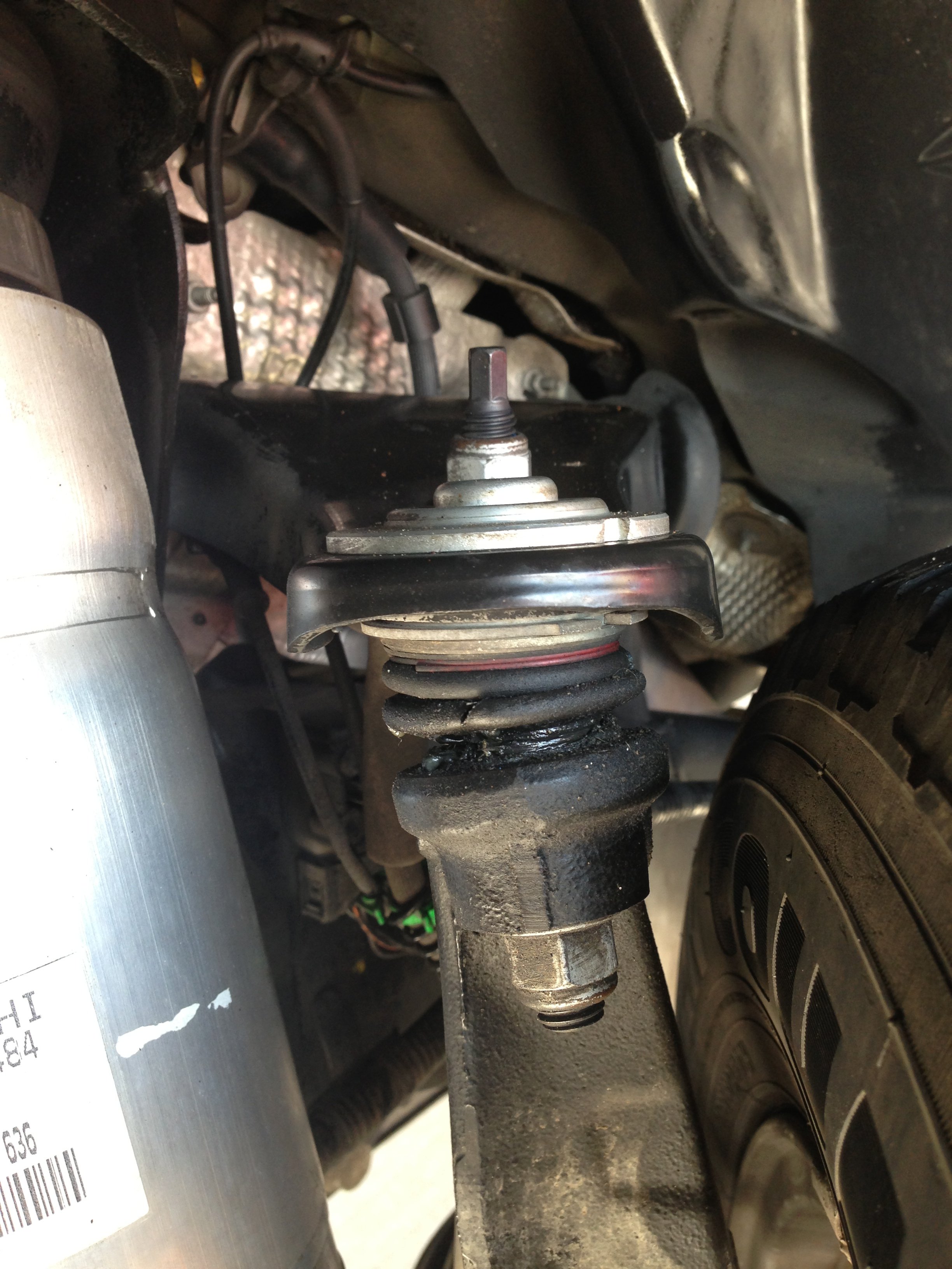

Hi! Please help to identify this part and what cost It will run into to get that fixed? How urgent it needs to be fixed?
Thank you everyone for your time.
Martyn
Is it making any noise yet? Like a clunking when going over bumps? It is a safety hazard, as water could get in and separate the joint then the wheel would fall off. But if it's not clunking yet, you have a bit of time I think. Definitely get fixed before winter/first snow.
thank you for your reply. it doesn't make any noise yet but I will most definitely have it replaced with new arm soon. Looks like there is still plenty of grease in so i hope it will last me at least one more month utill i take it to the shop.
Thank you again!
