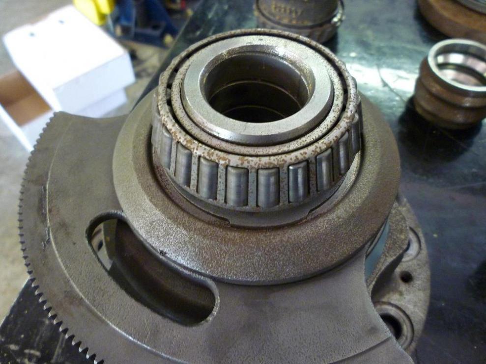

There has been no design change in the diffs by Land Rover. There is aftermarket improved parts, Ring & Pinion and seals.
The main problem being, that the Differential fluids should be changed every other oil change. By the time the first recommended service occurs, the bearings and parts have developed rust and are beyond repair. From there, the bearings self destruct due to the rust.
A swapped unit, or rebuilt with improved parts, and regular oil changes will ensure trouble free service for a long time to come.
Parts and Units better than OEM are available.
