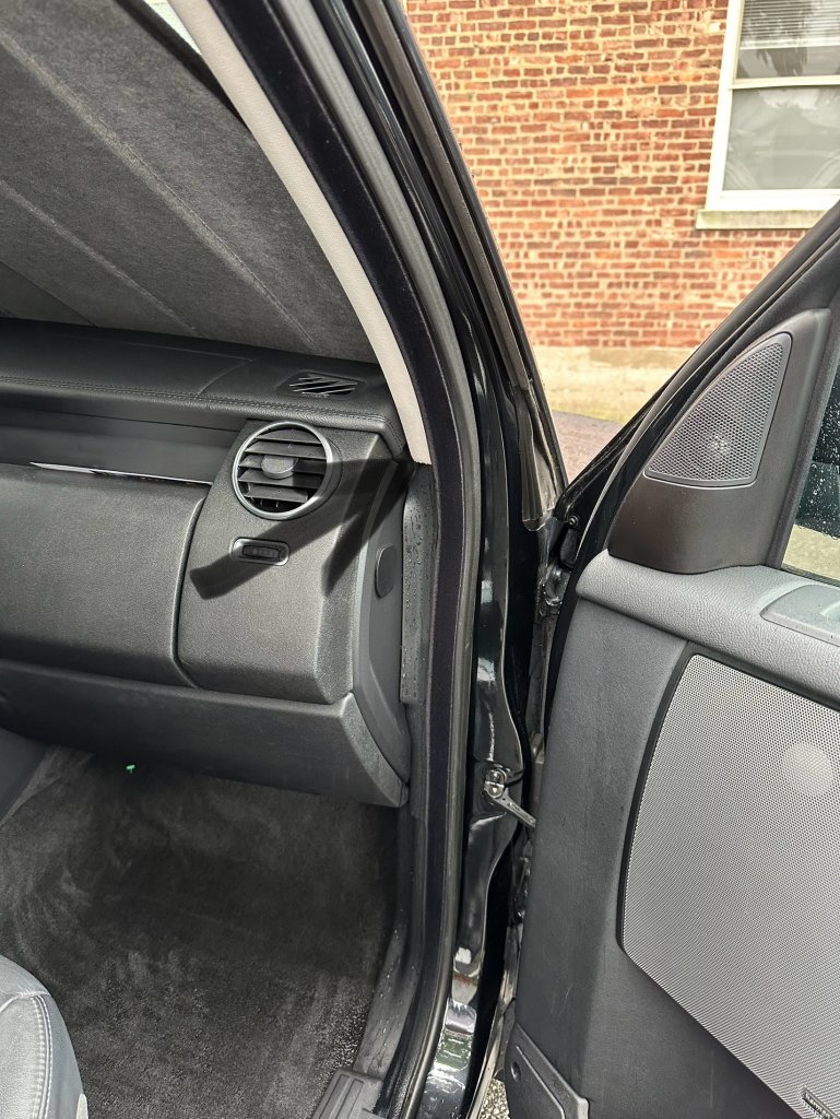

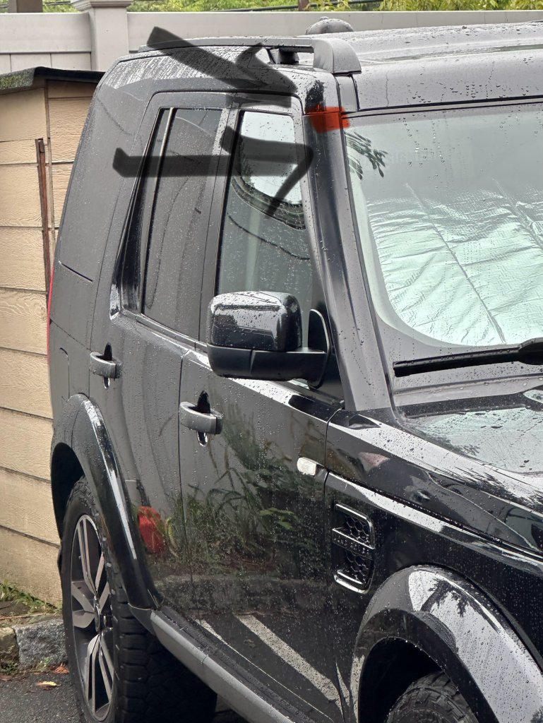

I just found the passenger side floor flooded, I thought my wife left the door not fully closed, did vacuum the side right away and this morning the floor is completely wet again because yesterday and todays rain. I did spray water using the hose and found water dripping by the right side of the dashboard, see picture please and I believe the water is getting in by this part of windshield frame, can someone let me know if they had this issue and how to fix it.
I don’t want to bring it to the dealer because they will charge a lot to fix this.
Any help will be appreciated.

I did cover my LR4 with a waterproof poly tarp, before I did vacuum the passenger floor very well and few minutes ago I went to check my car again to make sure the water is not coming in but to my surprise the floor is wet again, I believe the water is coming from around the car cowl because I left it a little uncovered that section because my tarp is not big enough, I managed to pull it to the front and now is covered the cowl, I’m still wonder from where the water is coming, this really sucks as I love my LR4 and to see this things happen makes angry on how an expensive car can have these issues.
I hope I can find the issue, for now I have to wait as the storm is coming this way and I believe we are going to have rain today and tomorrow here in New Jersey.

The air intake for the cabin ventilation is just underneath the cowl, and water can drip into it if it gets between the windshield and the cowl (which can happen due to aging). Folks have made 'extensions' for the sheet metal that is intended to prevent that, to keep the water dripping down.
