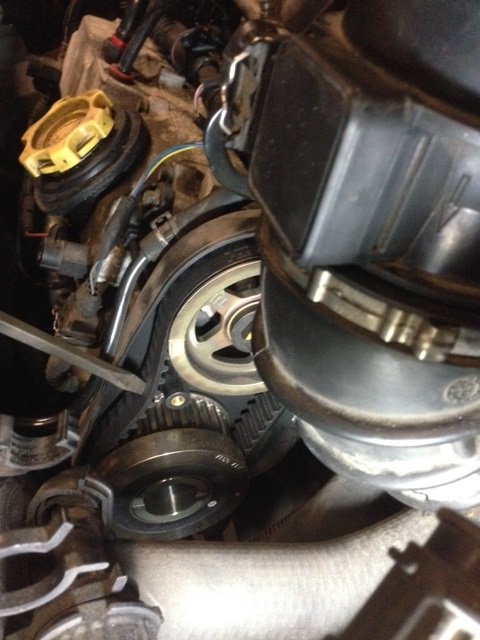

Ok, I First checked the compression on all cylinders. They range from 180 to 220. Then I changed all of the plugs and replaced all of the coils. Seems to run smooth but there is this strange knock??? It got too late so I didn't try to take it down the road. Any thoughts??

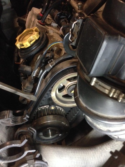

I found the noise, it is coming from the Timing belt on Cylinders 1,3 & 5 closest to the Battery. It sounds and looks like it is slapping the plastic cover on one side. What do you think?

I removed the cover and the belt looks like it is slapping the cover. I attached a couple of pictures for reference.
