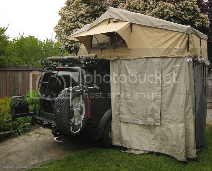

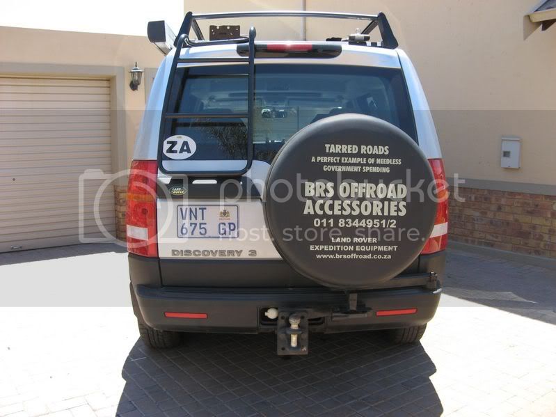

Would you care to post some detailed pictures of the apparatus? I'm looking to make my own an wanted to see how it connect to the frame through the bumper.

I don't have it but there are lots of pictures out there. Here's a link:
http://www.britishpacific.com/lrpartsSite/landroverparts/LR3swingAway.htm
Here are some more pics:
