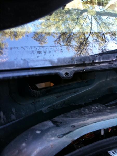

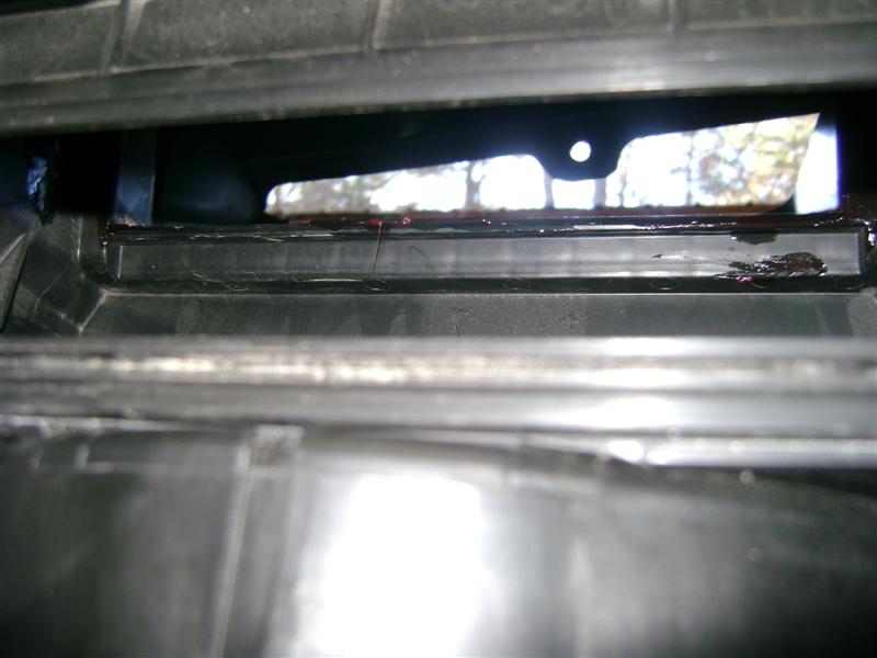

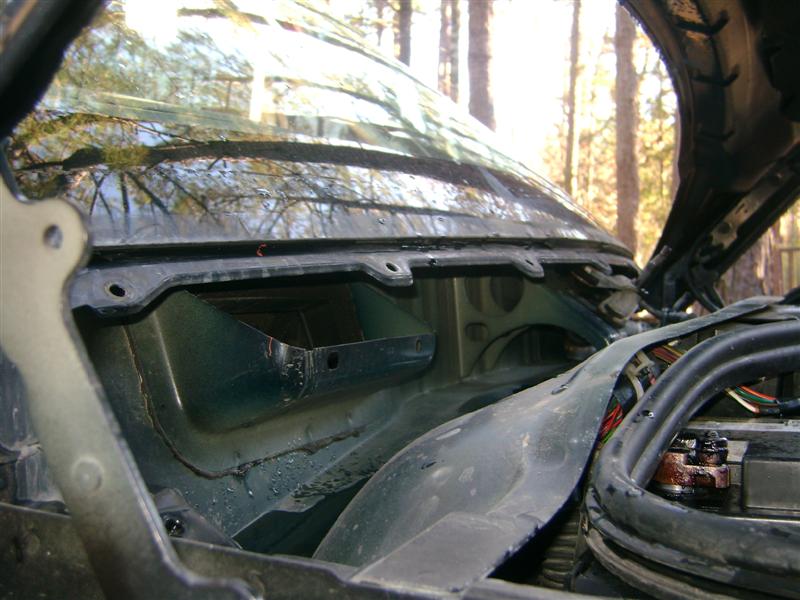

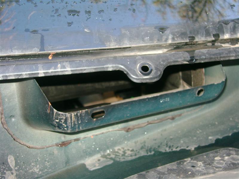

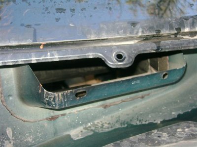

I am not sure if anyone has taken apart the cover to the windshield wiper motors, but I believe I have discovered the cause for many peoples water leaks and blower motor problems. If you look at the picture notice the light comming through directly under the windscreen. Thats where the in cabin air filter is located. Water can pass directly through down to the air filter and into the blower motor and will eventually end up on your floorboards.
