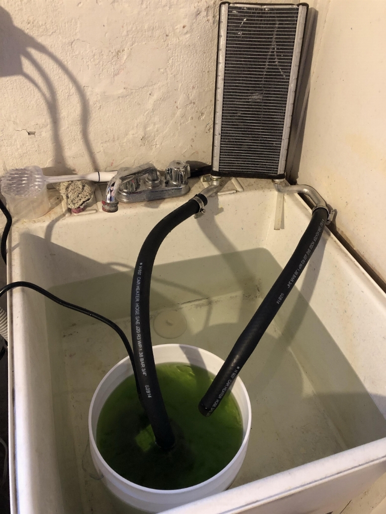

Using the same fish tank pump (its big from Amazon), some CLR, heater hose and a bucket I went ahead and did a bench test of sorts. I filled the laundry tub around the bucket with hot water to keep the process warm.

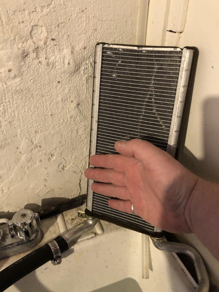

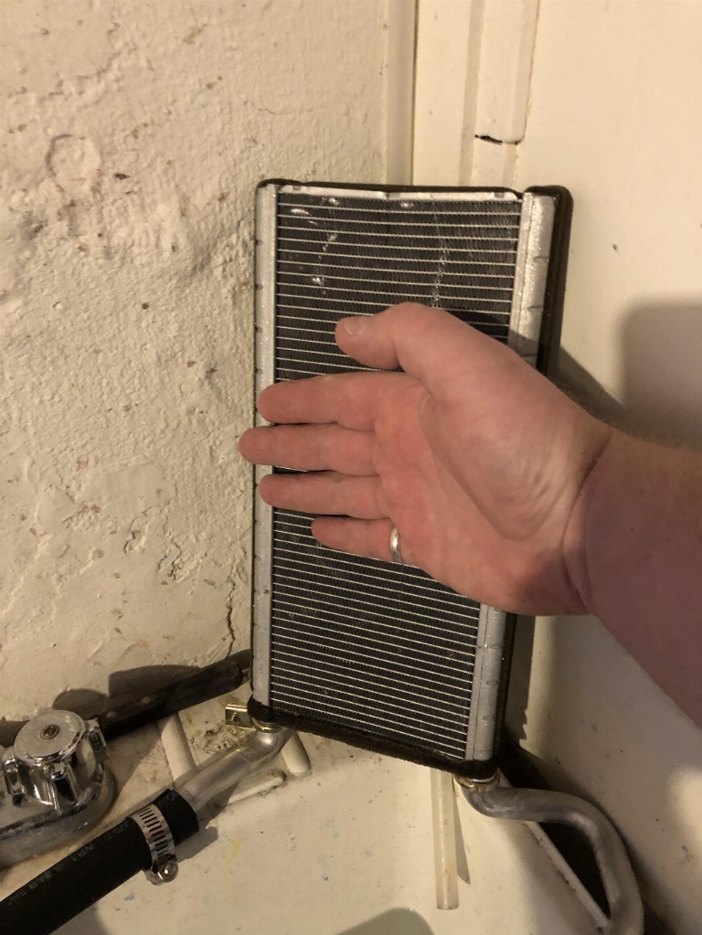

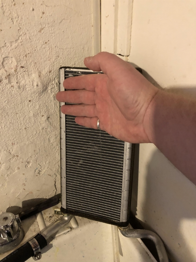

Low and behold, the end closest to the passenger side was getting nice and warm, but the other end was cold. Did the back of the hand test. It was literally at the 3/4 point is where you could feel the temperature drop off. This explains why the vent closest to the drivers window was occasionally lukewarm, but the vent closest to the radio and the footwell were always freezing cold.
I’m going to leave it with the CLR pumping through it to see if it will eventually unclog itself, but if not, its time for a new heater core.

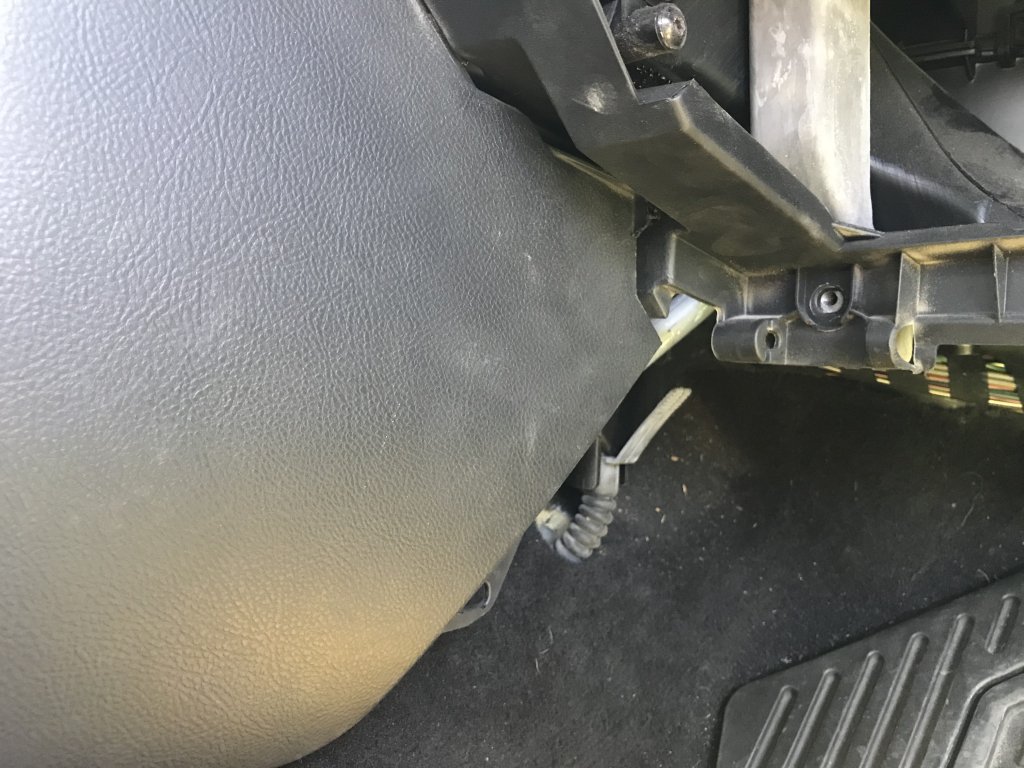

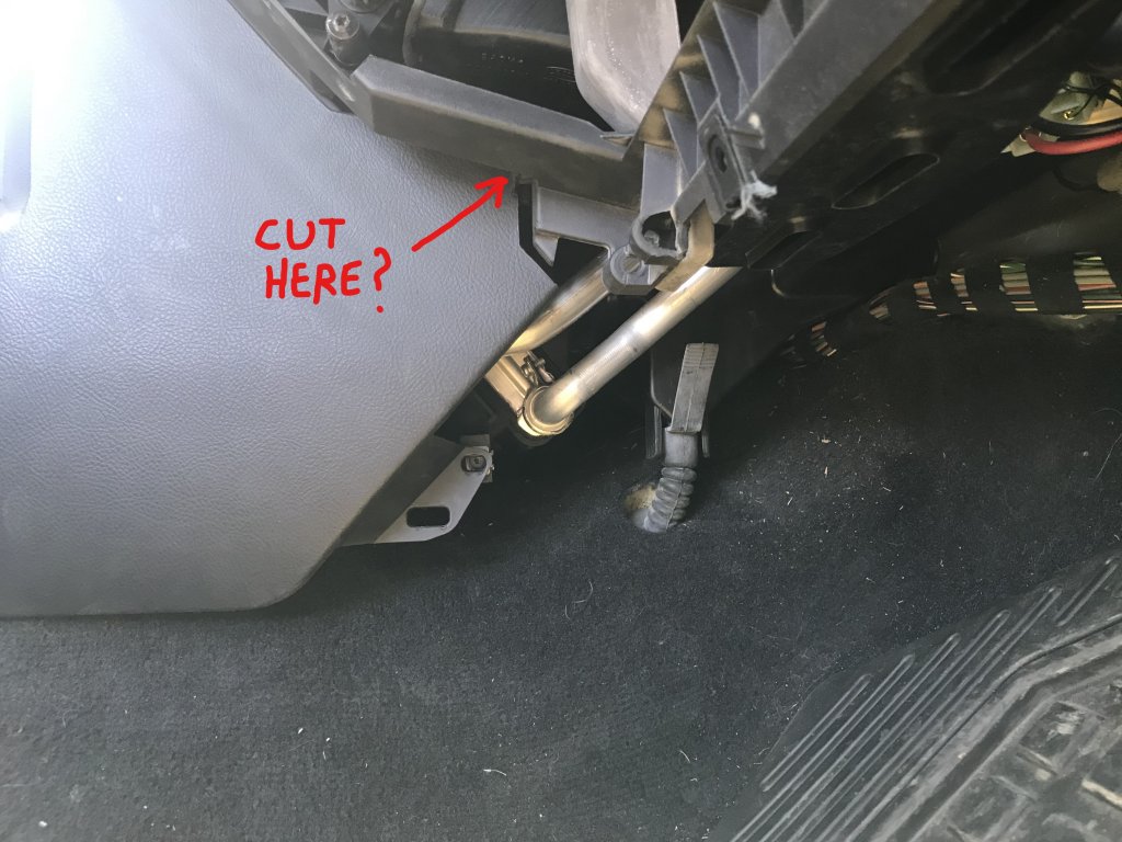

I'm trying to short cut the heater core replacement - did you cut the plastics here to peel back the side panel for access or ? Also, I'm thinking to leave the pipes from core to bulkhead or any tips for that?
