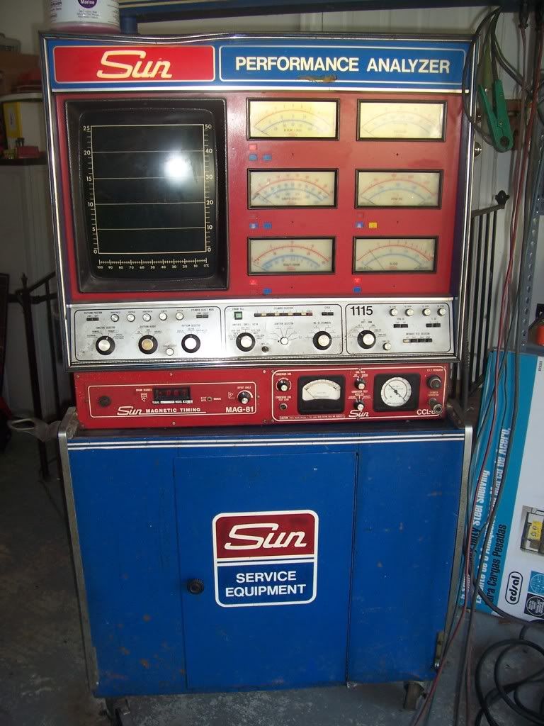

To really **** off the Pope I also have a Sun Investigator 1400 vs this 1115 Sun with the leakdown tester and capacitor checker.
