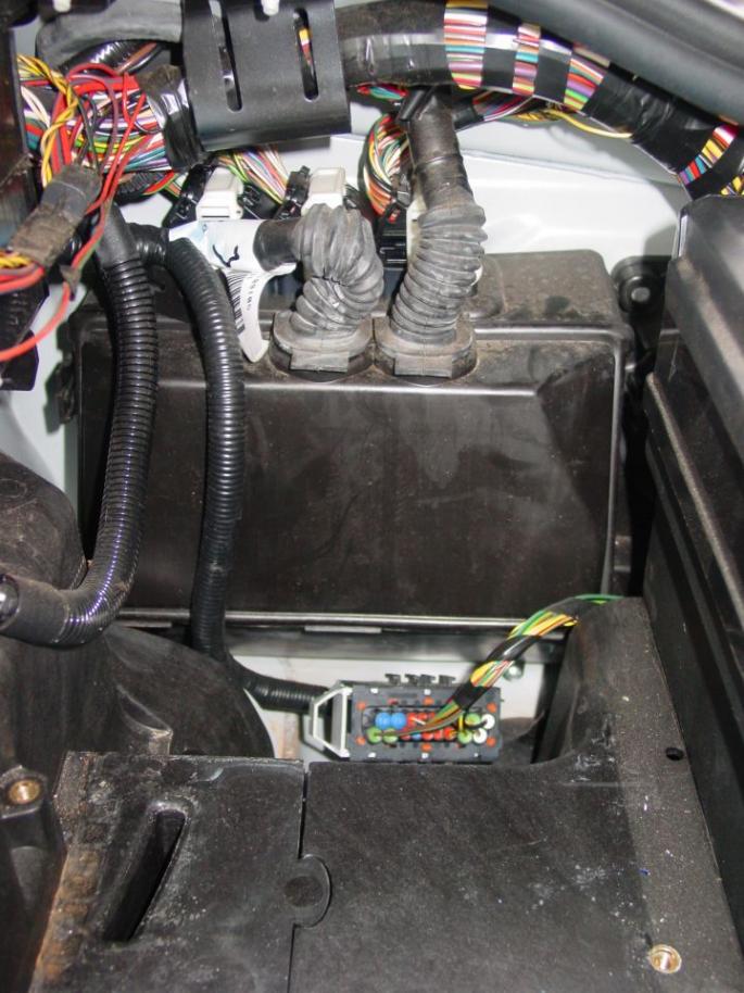

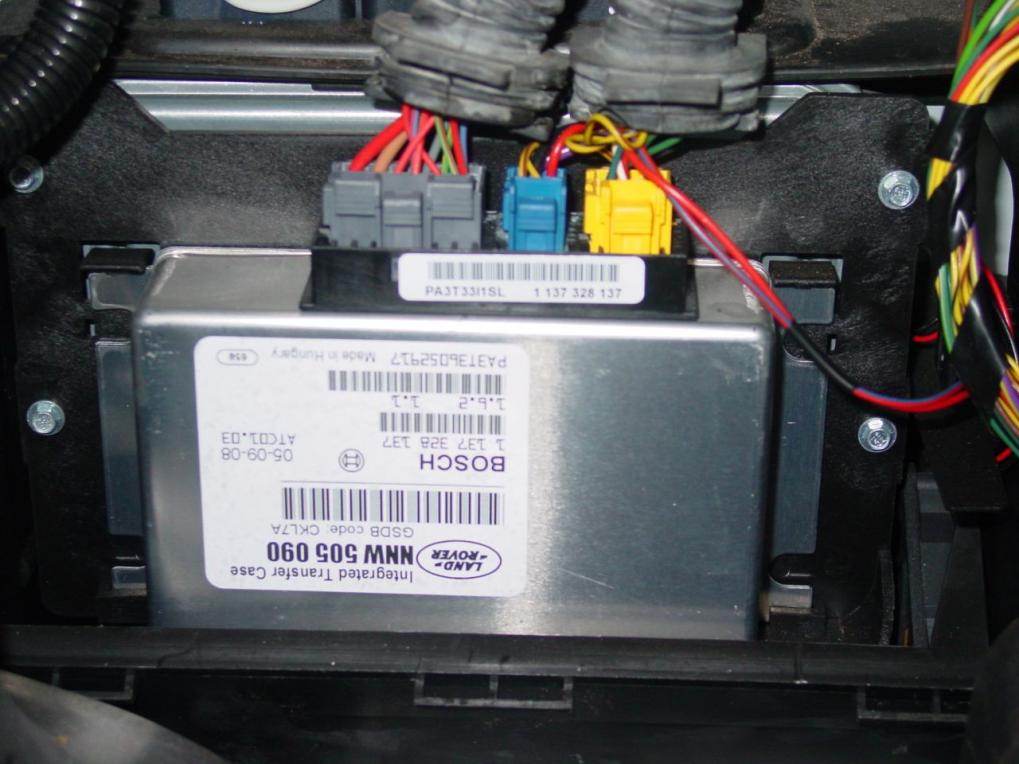

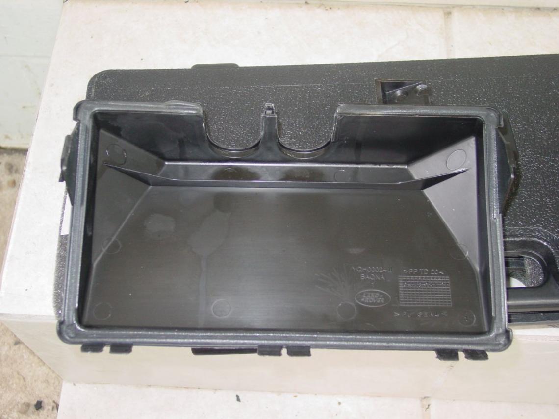

Well the Transmission Module dislikes dampness.
Hidden to the rear of the starting battery and sort of under the right side wiper is a collection of transistors called the Transmission Module. Do not be fooled by the rubber boots etc where the wires go in. They are there to channel the water onto the circuit boards within. You may wish to wrap some 3M +33 black electrical tape around the top of the boots to slow down the channelling effect.
The plastic cover itself is a plot to lure you into thinking that the cover has a water resistant back to it - wrong - no back - surprise - it is just a cover.
To clean my engine, I treat is as an heirloom using a combination of Spray 9 and various rags etc along with WD40 and Windex.
Yeah, I know, that sounds a bit irrational but so does a printed circuit board cover that is a sieve on a vehicle built for swimming - well swimming to about the top of the wheel wells anyway.
I guess that is what the lift feature and off road height is for but I suggest the garden hose be used on some other vehicles engine.
