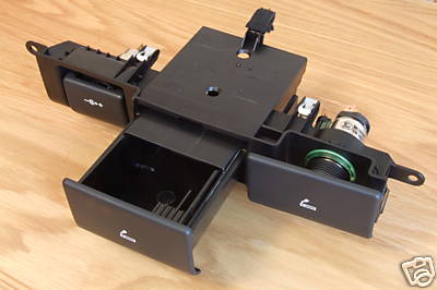

Common failure, had to have mine replaced. The replacement assembly includes the ashtray, lighter, power socket. Price was ~$35

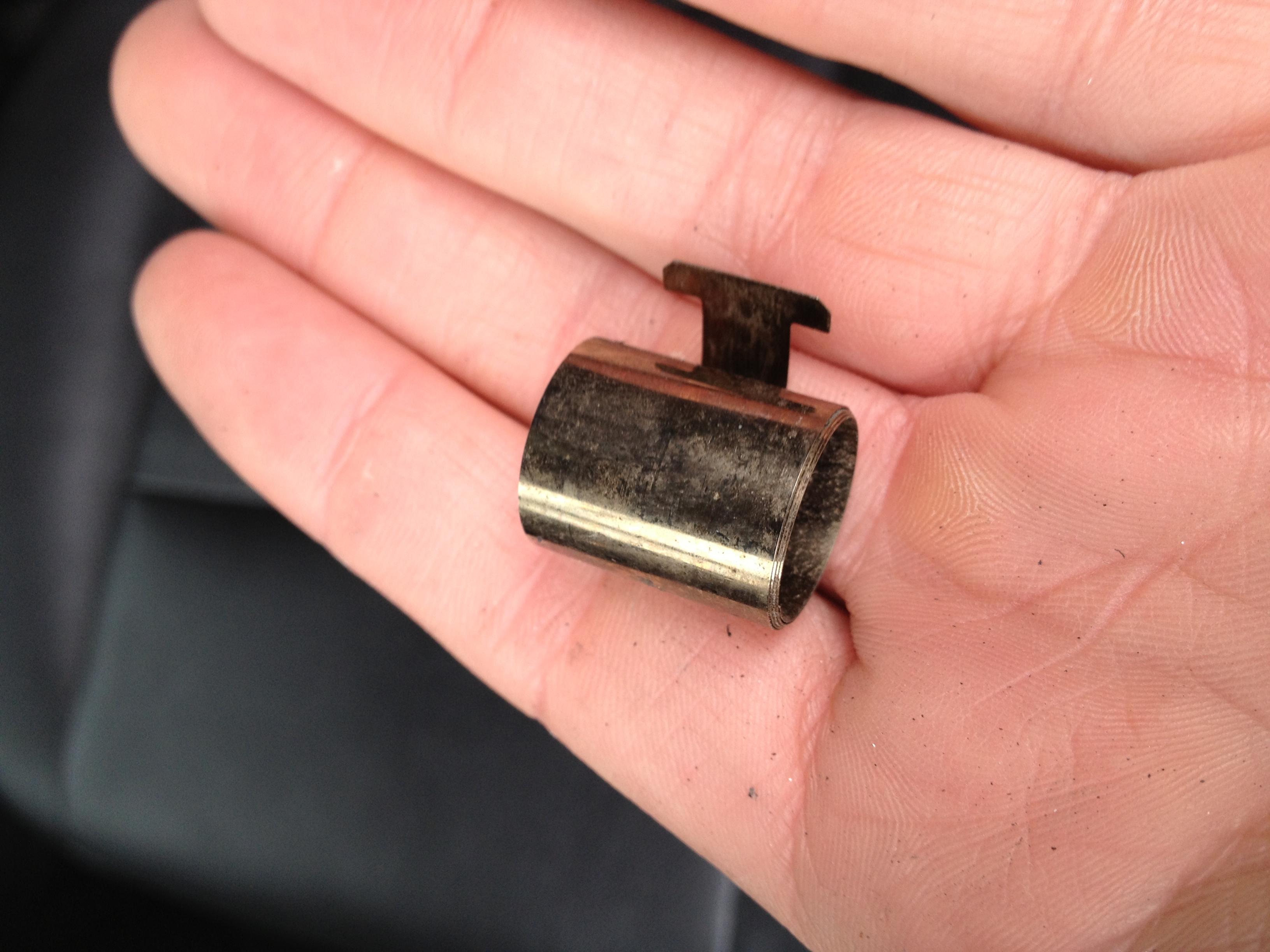

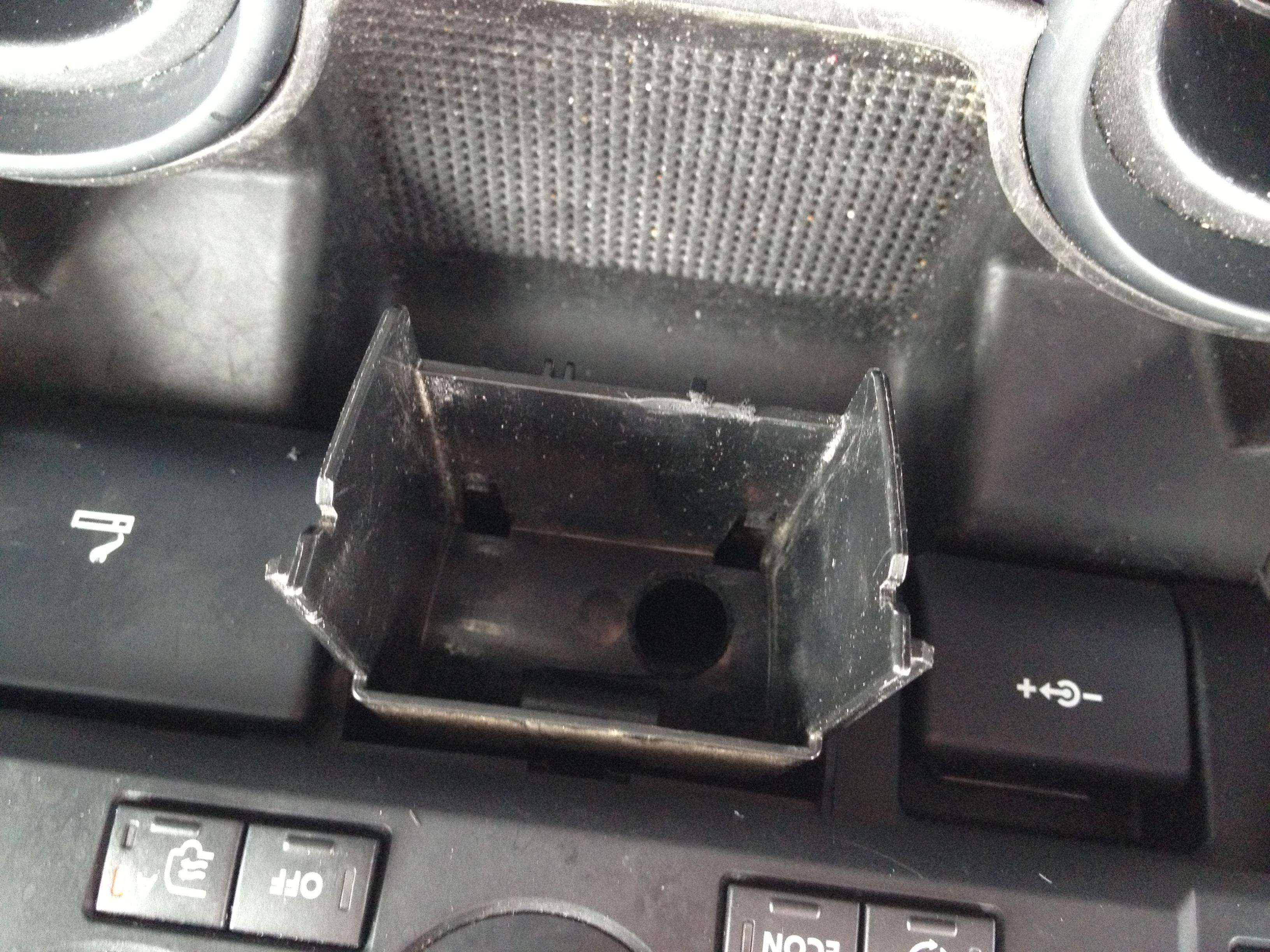

I had the same problem where the spring that allows the ashtray to glide open and close broke and was stuck behind the ashtray.
Rather than rip the dash off and replace the entire component or take it to the stealership I drilled a hole in the housing and yanked the spring out with needle nose pliers.
See pic of hole and spring.
The ashtray is now simple to open and close (win) and didn't cost me a penny (win).
