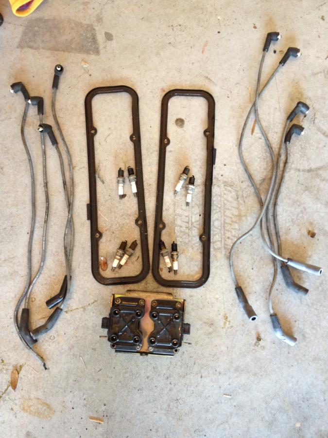

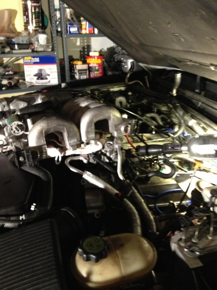

Mike ????I replaced all the parts and I have the same problem P1300 ignition control .P303 and P307 ??:help:
spark plugs
ignition wire
ignition coil
valve cover gasket
